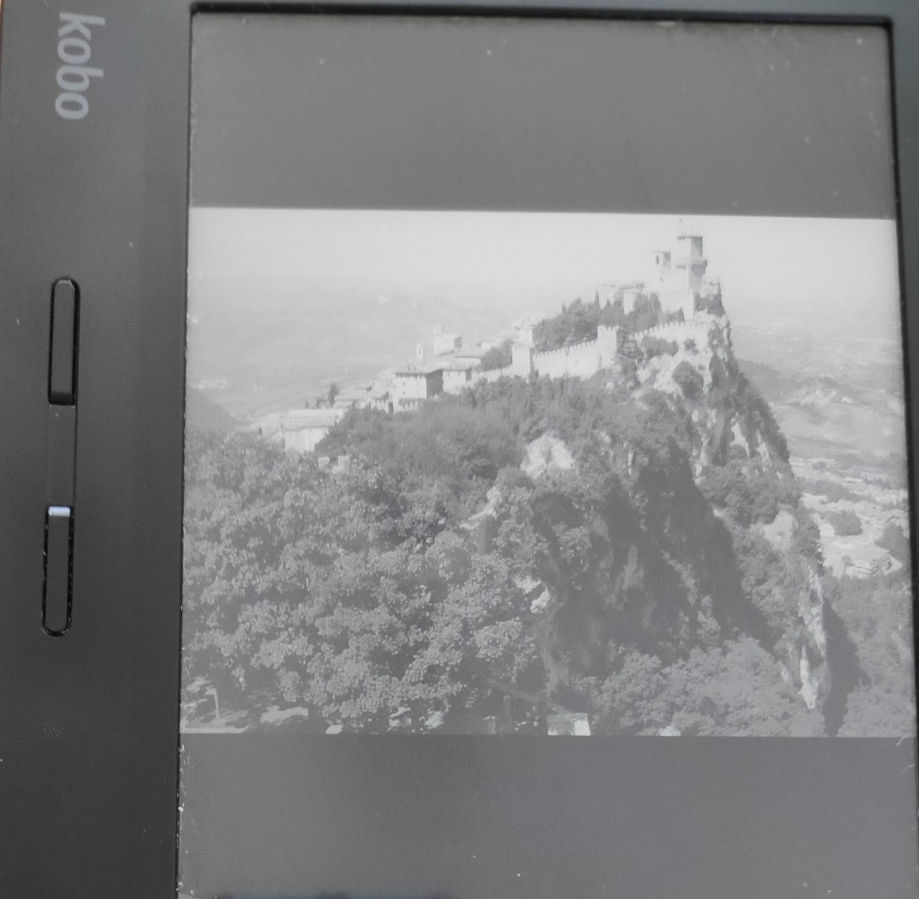

Yesterday I changed from having my current read's cover show when my Libra is sleeping/powered off to showing a screensaver. Now, as the attached screenshots show, it's impossible to tell the difference between sleep and powered off. With book covers, if I accidentally held the button too long, I could see "Powered Off" on the screen, or "Sleeping" if not. Can I have that with screen savers too?

Turn on the info panel and you'll know the difference between sleep and powered-off. The info panel option is in Settings > Energy saving and privacy. Also, you'll have tog o back to book covers.
Thank you for completely ignoring what I had written and sharing irrelevant advice. The settings you describe explicitly state that they apply for, and I quote "full screen covers". Those boxes are ticked and the info box did show when I had fullscreen covers enabled. Since the whole point of my query was about a changed situation, had you bothered to pay attention to the content of my original post you might have perceived that you were not offering anything of value to the discussion. Unlikely, but not impossible.

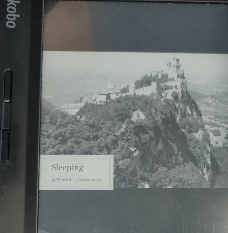

One of the Kobo patches for libnickel.so.1.0.0.0 says "Allow showing info panel on random screensaver". This may do what you want.
Thanks again - PERFECT result! As a bonus, the info panel is much less intrusive on my chosen screensaver than it was on the book covers.
