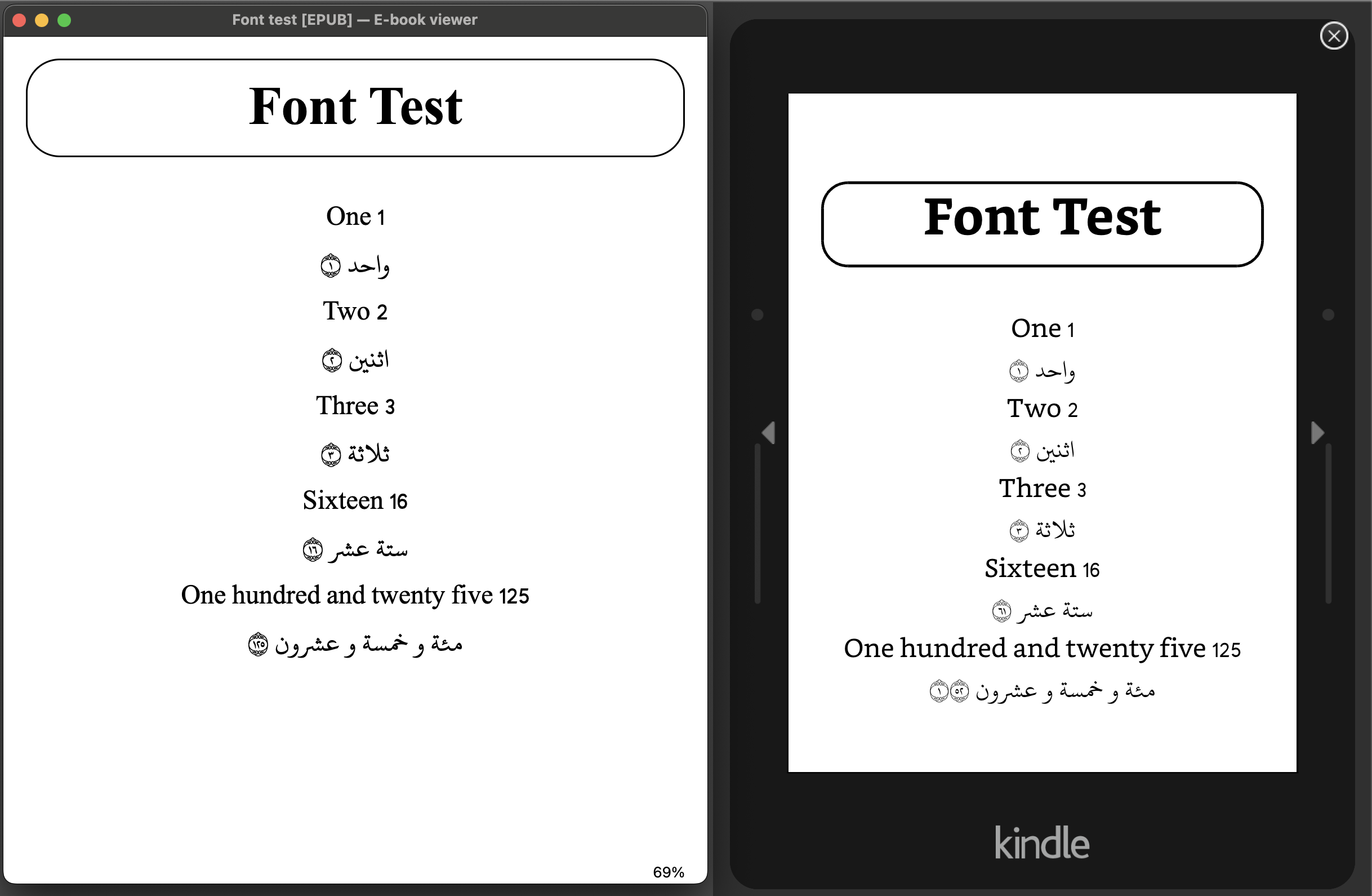

Hi,
I am kinda new to creating books for kindle, especially KFX format.
First, I am trying ti write an Arabic ebook with special font that has special font character for each number.
However, I am having and issue with how kindle previewer render these characters.
As you can see in this picture.
Lift side: Calibre Reader
Right side: Kindle Previewer 3
Name:	Screenshot 2024-03-20 at 11.24.40 AM.png
Strangely, I have encountered the same issue in the software I am using to edit this book.
Lift side: Sigil 1.9
Right side: Sigil 2.0
Name:	Screenshot 2024-03-20 at 11.37.20 AM.png
Does anyone know how can I fix this issue? Or force Kindle Previewer to use new renderer?

It can be difficult to get embedded fonts to work properly on the Kindle platform. Sometimes the you need to select Publisher Font in the reader to see them.
You might receive more help if you provide an e-pub file that demonstrates the problem. Perhaps there is a problem with your html/css.

I see the same rendering issue in the Kindle Previewer. I also tried converting it to KFX and viewing it using the Kindle for iOS app and that produced the same results as the Kindle Previewer.
From what I can tell the numeric glyphs in your font have some sort of attribute that indicates they are to be combined into a single glyph when rendered. This is probably something that just isn't supported properly in KFX. I don't have any suggestions of how you might make it work.
