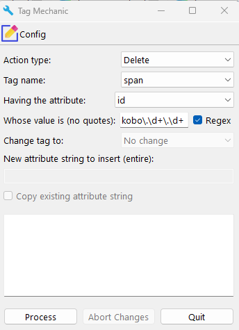

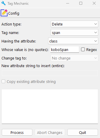

You could use regex to remove those spans however TagMechanic is a safer solution since it handles nested spans. I would suggest installing TagMechanic, selecting the files you want to remove those spans from and then running TagMechanic. Select the action as delete, the tag name as span, the attribute as class and the Whose value is field as koboSpan. Click on process and then commit and exit. Note that some books will not have the class= and you could try using the id attribute instead. That will require setting the Whose value is field using a regex such as 'kobo\.\d+\.\d+' without the quotes (basically matching any string of the format kobo.number(s).number(s) )
ID:	207104   Click image for larger version
