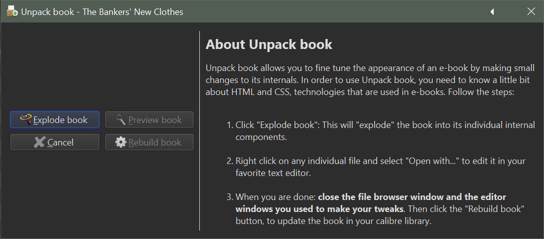

Perhaps you could use the Calibre Unpack tool: it provides 'Explode' and 'Rebuild' features.
Name:	Screenshot 2024-03-10 140055.jpg
