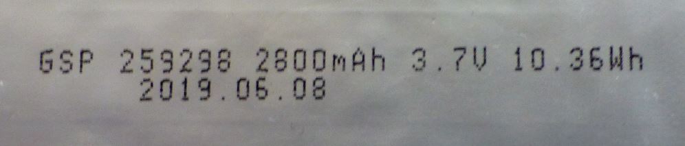

NOVA Pro - How to disassemble an change the battery
Hello eBook Freinds,
After my Totuorial on the Pocket Work, Inkpad3 (https://www.mobileread.com/forums/sh...hias_BL&page=3) my device got later on, a mechaincal crash, due to a construction item falling on my backpack with was the reader whithin.
So I decided 2.5 ago to switch the manufacturer to ONYX BOOX - I got a NOVA Pro. Well after having been happy (regardless the crashes/freezes one or twiche a week) now the accu issue has become upfront. Again
Got an accu from 2019, which is now to crumble. 100% loaded after 2h reading become 70%, 1h more reading the loading sign has been shown.
Interessting: Getting the Device back on USB Loader, then putting on, 58% of Battery load was displayed - like as the shutdown and charge message was never been shown.
So I decided to replace the accu of my eBook (again).
This will be this Tutorial about (and also with hints to replace screen).
It's a pitty about these eBoox: ONYX put on Market 7 (seven) new devices, but bought devices from about 2.5 Years are no more supported.
Dont want to start a discussion about environment and waste of ressources, but I am not so less upset about this kind of money making!
There is more to come.
Best Regards
Matthias

Next steps: Get an new Accu
(!!! Did anybody know from whre to get - besinde china? 3.7V, 2800mA, Size 90*90mm, 4-5mm thickness, 10.36 Wh) ,
then to remove accu (will also be documented here in this Tutorial), then solder out the old connections, build in the new ones, put all the things together an - hopefully - having fun for the next couple of 4-5 years.

Neverthelss, back to the topic:
A 3.7V 2800mA was built in the NOVA Pro from factory, but I decided to enhance the replacment up to a 4000mAh (hoping ONYX charge electronics can handle that).
As you can see on the pic (red circle) the main board of the device, has two different power supply methods.
