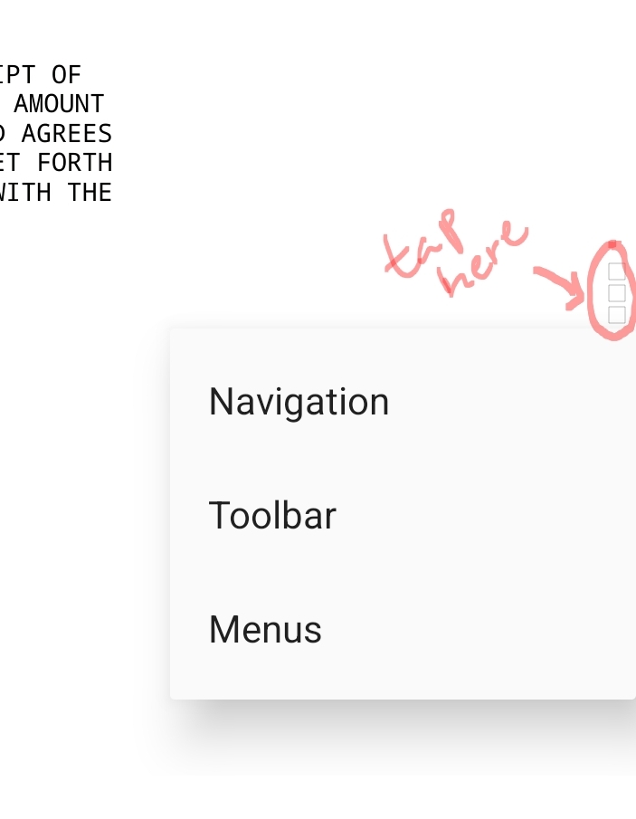

Just in case someone still needs an answer to this question (that I accidentally solved recently):
• There are 3 tiny almost transparent squares lined up vertically on the middle right edge of your document.
• Tap slightly to the left of these squares and a pop up menu will appear listing: [Navigation / Toolbar / Menus].
• Tap on [Toolbar] and it will reappear on the top of your document.
