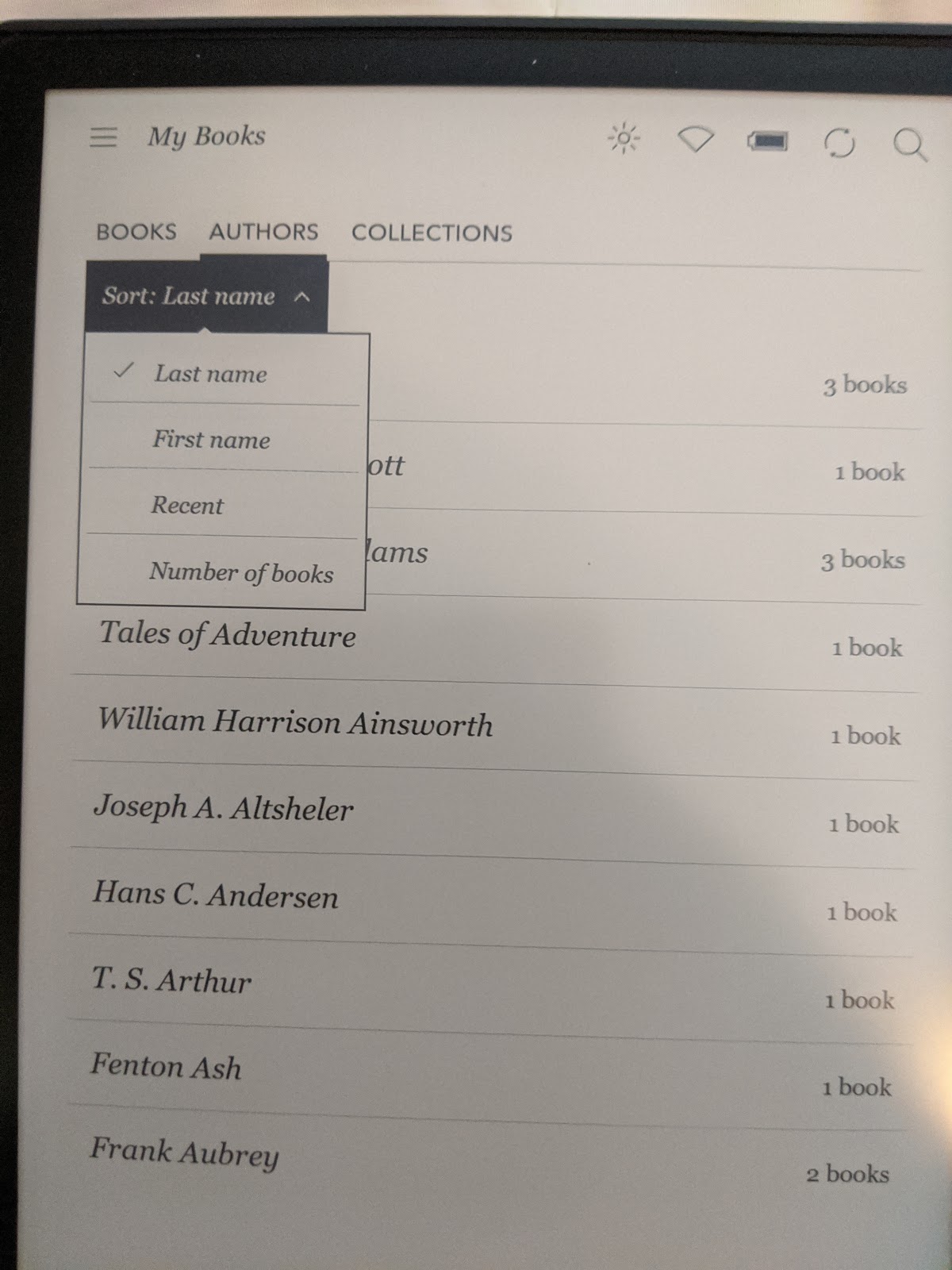

Not the answer you want but my solution was to buy a Kobo; see attached for how you can view books by author properly.
If I remember correctly there is a plugin for calibre that will redo all of the author names to be lastname, firstname. Which is what I'd done, and then I used it again to put them back to the correct format after I bought the Kobo.
