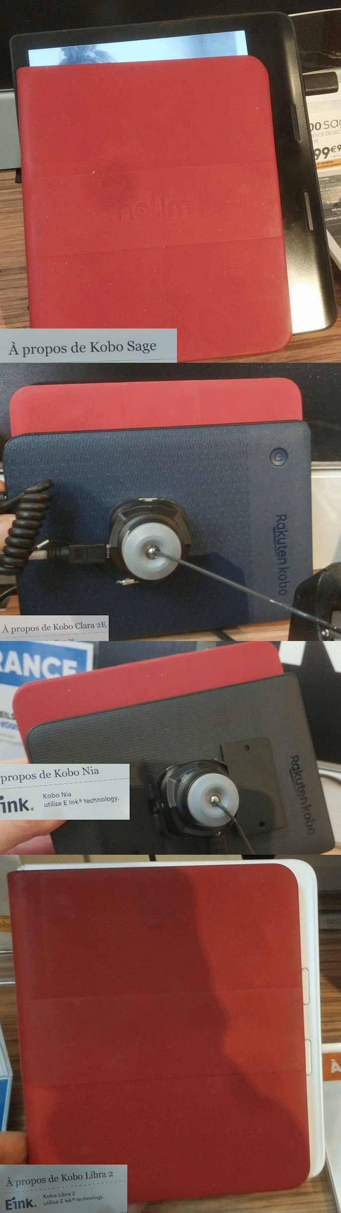

The store had five different models. Forgot the name of the 10" where you can write (Elipsa ?).
I find the Sage too big, while the Nia and Clara 2E are smaller and the Libra 2 is about the same.
Like I said in the OP, the whole point of getting a new e-reader is precisely to read PDFs better than on the Bookeen Saga, or I wouldn't bother.
Why does screen size matter when viewing PDFs ("No 6″ is good for PDF, unless it extends like the communicators in 'Earth: Final Conflict'.")?
Because PDF is not a reflowable format. You can't increase font size; you can only zoom in on a part of the page, if that. The smaller the screen, the less of a page you see, or the tinier the content is.

Sage W x H x D is 160 x 180 x 6 mm, but side with buttons rises to about 8.5mm.
Libra 2 W x H about 144 x 162 mm, so smaller.
I don't have any Kobo 6″ model here.
KOReader, or any any other program, will not help with most PDFs on a 6″ screen any more than the native reader.
A proper ebook dynamically uses the actual screen size (based on pixels) as the page size when you open it. The user can change the font size, or even face, line spacing, margins etc (unless the ebook designer messed up).
PDFs, Fixed Layout or other Print Replica use a page size decided by the designer or publisher. The user can never change the font size, or face, line spacing, margins etc. The PDF can be shrunk to fit, in which case the text may be unreadable on 6″, or 'actual size' in which case you only see part of the page unless your screen size/resolution is as big as the design page. Hence sometimes even 8″ or 10″ isn't big enough if the PDF is A4 page and 6 point size fancy serif text.
If you go for 6″ then only a few PDFs will be readable in any easy fashion.
