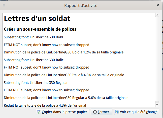

When subsetting my usual fonts, the reporting little window under each of the three fonts tells me:
FFTM NOT subset; don't know how to subset; dropped
Nevertheless the subsetting process takes place.
However the downside is that I lose the display of open-type properties (like old numerotation, etc.) in the subset.
Calibre 7.1. has been installed using the linux script provided by Calibre. Maybe some fonttools software is badly installed? I have python-fonttools 4.44.3-1 installed.

Thanks for your reply.
I use the binaries provided by the Calibre Linux script, currently at 7.1.
In the joint png screenshot you can see the error message I am getting when I ask Calibre to make a subset.
In the zip, I provided two examples of the same ePub3. This book was published by me on MR in 2018 and I slightly modify it for this purpose. As there are nineteenth century letters, the use of an old numerotation makes sense.
- The first one is before subsetting, where you can see, for example, that the Date at the beginning of each chapter uses the old numerotation (open-type).
- The second one named (calibre-subset) is after subsetting where you can see that the Date at the beginning of each chapter does not use anymore the old numerotation.
So this error message seems to have an impact, even if indirect, on the open-type display.

Old 11-30-2023, 09:18 AM   #4
Posts: 45,696
Karma: 28549304
The error message has no connection. Subsetting simply doesn't preserve open type feature variations. Maybe someday I might add support but its not a priority for me, patches welcome.

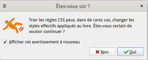

I note that the Calibre editor issues a warning before sorting the style rules (see attachment-in French sorry).
Maybe, for the time being and as it is not an obvious behaviour, would it be useful to add such a kind of warning before launching the tool "subsetting of included fonts" which replaces existing fonts:
"Are you sure? Subsetting does not preserve open type feature variations."
