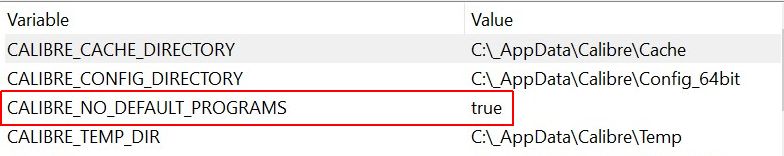

Did you set environment variable - it prevents the associations being reinstated.
Name:	Screenshot 2024-01-11 082439.jpg
Value doesn't matter, I use 'true' because it's explicit.
Attachment 205740
