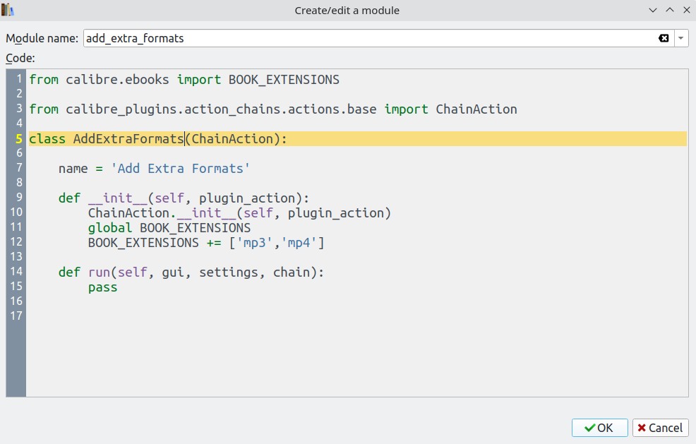

If you don't want to run from source as Kovid suggested in the the thread you linked, you can still do this using the Action Chains plugin as follows:
  • Action Chains > Manage Modules > create > paste the code below and press OK.
    from calibre.ebooks import BOOK_EXTENSIONS
    from calibre_plugins.action_chains.actions.base import ChainAction
    class AddExtraFormats(ChainAction):
        name = 'Add Extra Formats'
        def __init__(self, plugin_action):
            ChainAction.__init__(self, plugin_action)
            global BOOK_EXTENSIONS
            BOOK_EXTENSIONS += ['mp3','mp4']
        def run(self, gui, settings, chain):
            pass
  • Restart calibre and you should see the mp3,mp4 added to list of formats in device configuration dialog.
  • Connect to your device inside calibre, then go to Device > Configure this device > tick the boxes for mp3 and mp4 formats, after which you will be asked to restart again.

Hello capink,
thanks for the quick reply!
It's a great plugin, it worked wonderfully!
I just hit the donate button.
Thank you very much, Steve
