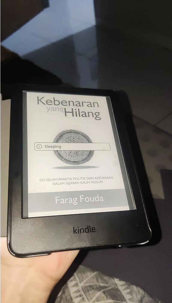

I am stuck in sleeping koreader, can't do anything, just stuck and lcd stuck in sleeping mode koreader.
LCD turn on when the cover off / when I am click power button. LED light turn on into yellow light and when I am hold power button LED turn on into orange 5 times dots.

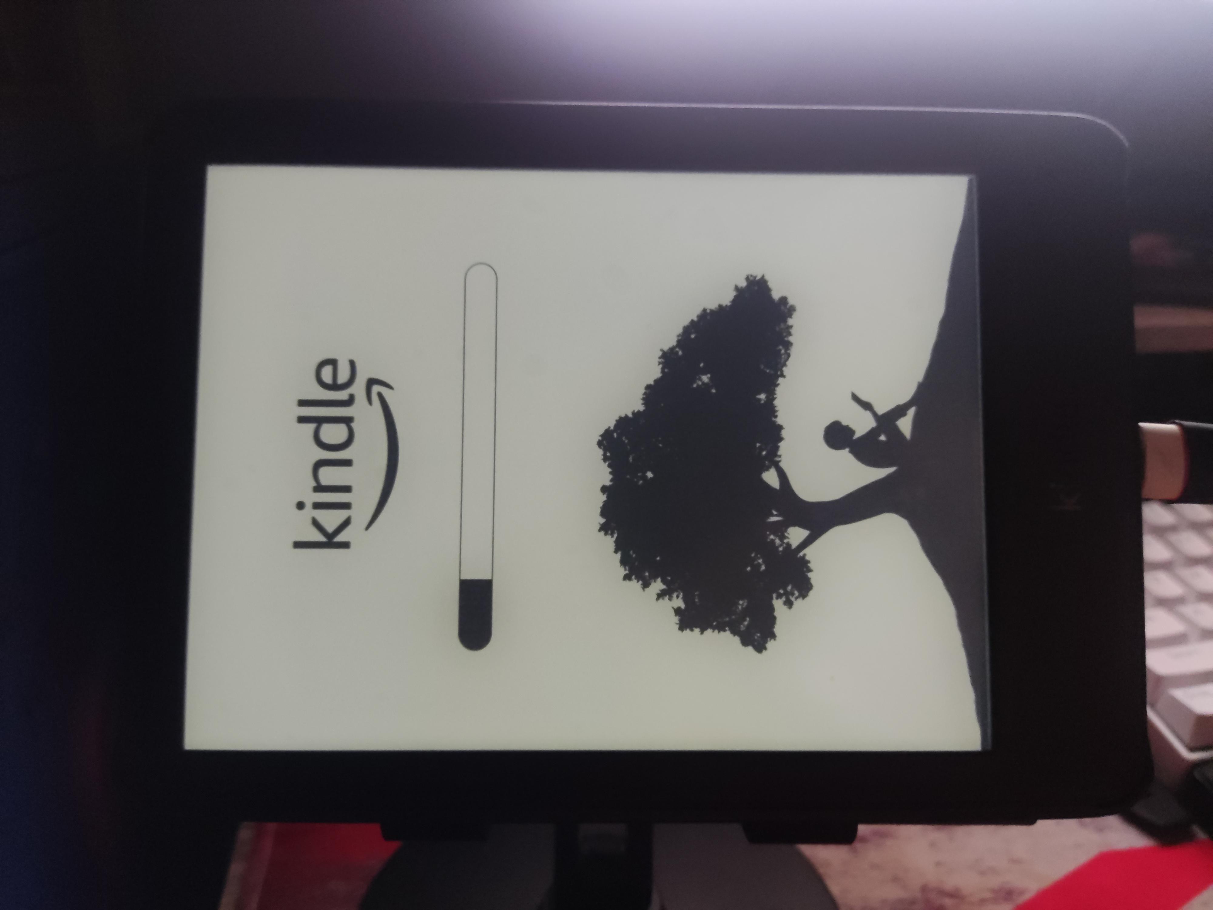

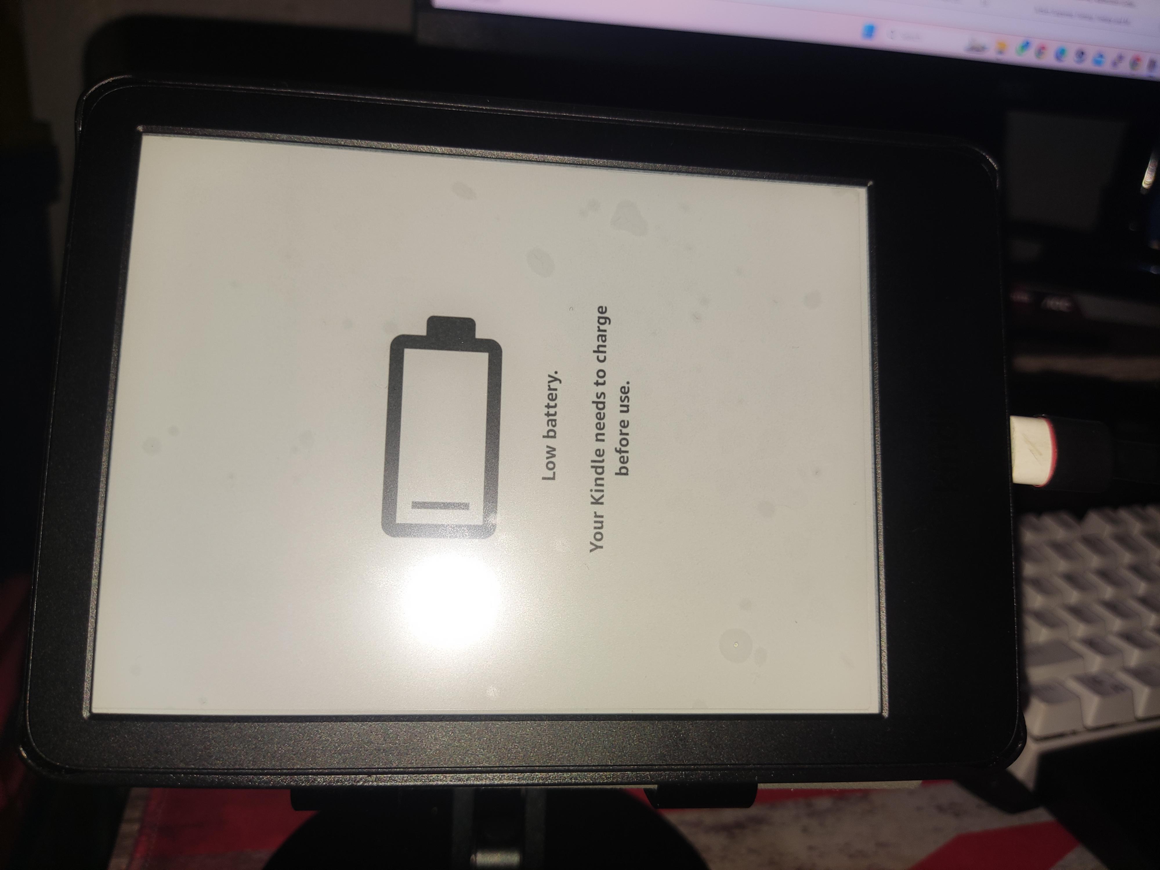

I have tried pressing the power button several times until the device runs out of battery, now the device shows the latest display when I charge it again. I will send any update in 4 hours

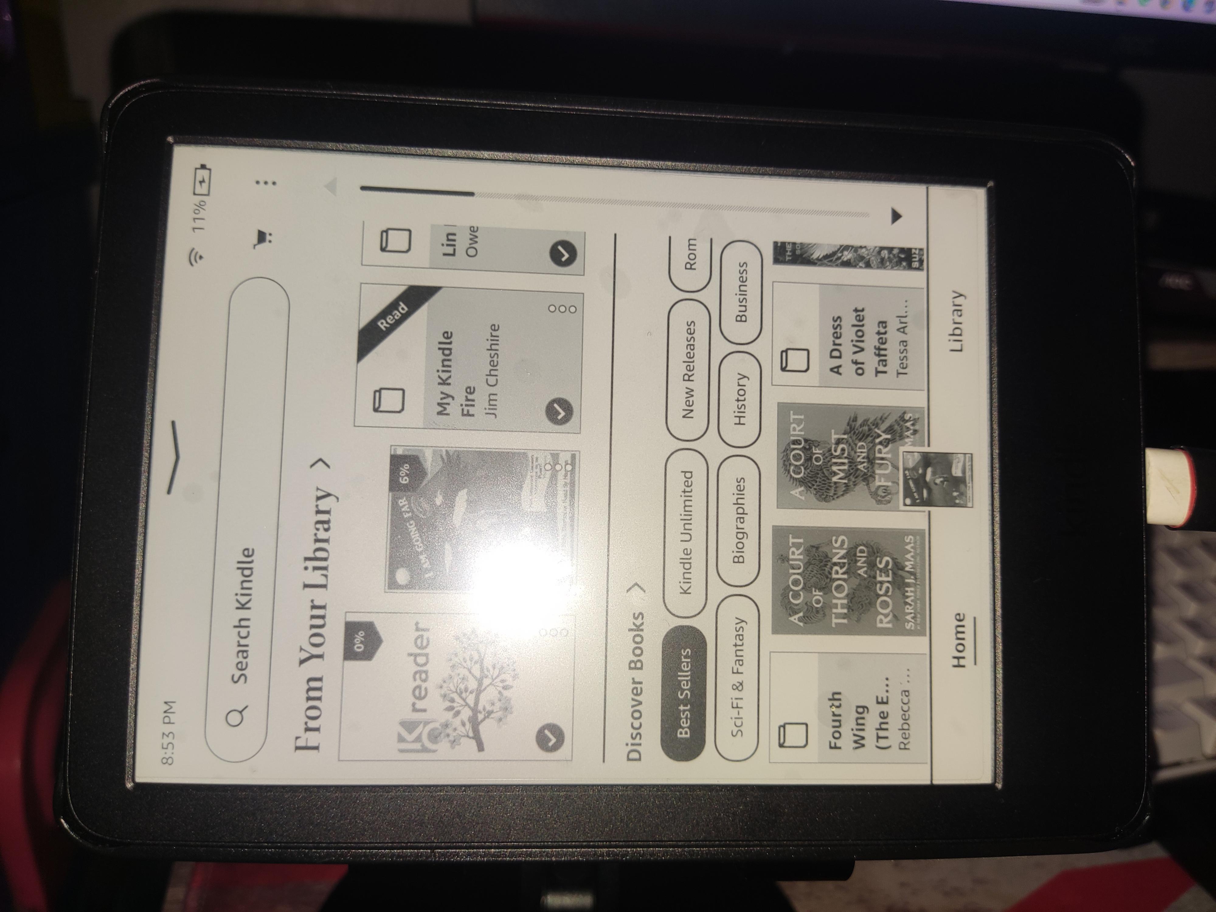

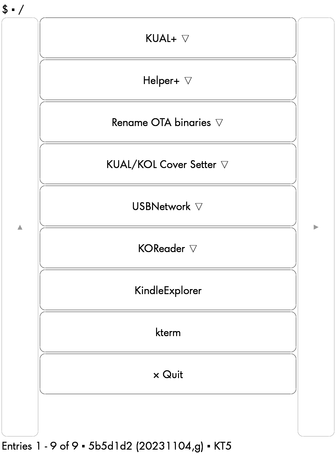

Its work fine now after i am Running out of battery, is there a way to bring up the power menu in koreader?

If by "power menu" you mean Kindle's menu when you hold the power button - not excatly. However, KOReader can ask Kindle to restart from its Top Menu - last tab on the right.
