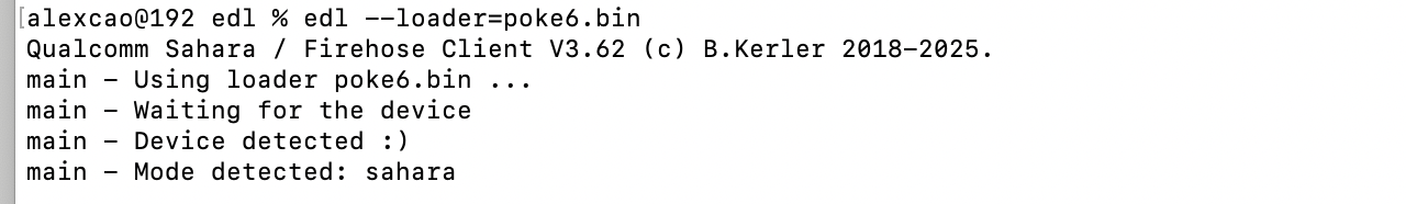

I’m currently using a Poke6 and I want to install the Go6 firmware on it so that I can sync my reading progress between my Poke6 and Go10.3 devices. I’m on macOS and have tried installing ADL, but something seems to have gone wrong because ADL doesn’t run properly.
Could anyone please guide me step-by-step on how to install it correctly? My device is still completely original and not rooted, and I don’t want to root it.
Thanks in advance for your help!

Each EDL client has a slightly different syntax for commands.
"/lpoke6.bin" is my syntax for the loader file "poke6.bin".
Python EDL uses "--loader=poke6.bin.
You can find that file at https://www.temblast.com/ref/onyxldr.htm
now it's stuck at here
and your link does not have poke 6 loader
Name:	Screenshot 2025-06-07 at 15.27.17.png

Originally Posted by bebeen87 View Post
Your link does not have poke 6 loader
Oops. Now it does.
Use the Go6.

After I copied poke6.bin into the edl folder, I ran the command edl --loader=poke6.bin from the terminal, but the command still hangs as before.

Unfortunately that is a very stupid piece of software.
It's hard to tell what is going on.
I don't know about getting it to work on Macs.
It might need permission or udev or something.
Don't you have a Windows machine somewhere?
Even Linux is better than Mac.
