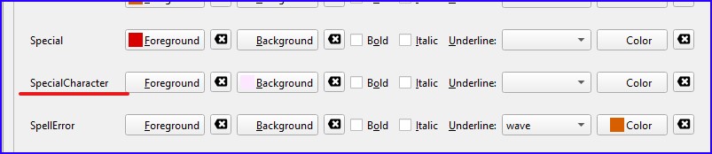

I am wondering if the following is expected behaviour.
I have added a background colour to Special Character as shown in the image.
The problem is that the highlighting disappears when the cursor is placed on the same line, so it is a bit like whack-a-mole when trying to edit special characters. Is that meant to happen?

Its probably conflicting with the current line highlighting, try turning that off.

Sorry I am not sure which is "current line highlighting". Is it "CursorLine" in the custom theme dialogue? It is not set but I clicked the X button to clear it anyway and it made no difference.

Yes its cursorline the other option is change the special characcter highlight style to use a different foreground color or an underline.
Thanks.
Yep using a foreground colour works in a limited capacity. As long as there is something to display, then it shows that character in a different colour. Unfortunately for non displaying items like em, en etc spaces, there is nothing to colour.
Then using an underline is too subtle and either blends into a misspelt word underline, or is just too hard to see at a glance.
I guess it's probably too hard to fix the conflict. No problems, I've been working with the issue for quite a while now, so just business as usual. Thought I would raise it in case no-one had come across it before.

I did indeed, I run in the very same need (and issue) than you, trying to configure the editor to make visible the special chars inside the highlight lines, but I've failed as well. I have to move the selected line downward to see if there is a special char in the targeted line, which is not very practical, but I can live with this :-).
Anyway, if it would be possible to give precedence to the background color of the special chars over the background color of the selected line, it would be helpful. But maybe it's a Qt feature, not a calibre one ?

https://github.com/kovidgoyal/calibr...7bc9ecd09a7616

Oh wow!! I wasn't expecting a fix.
Thank you @kovidgoyal
