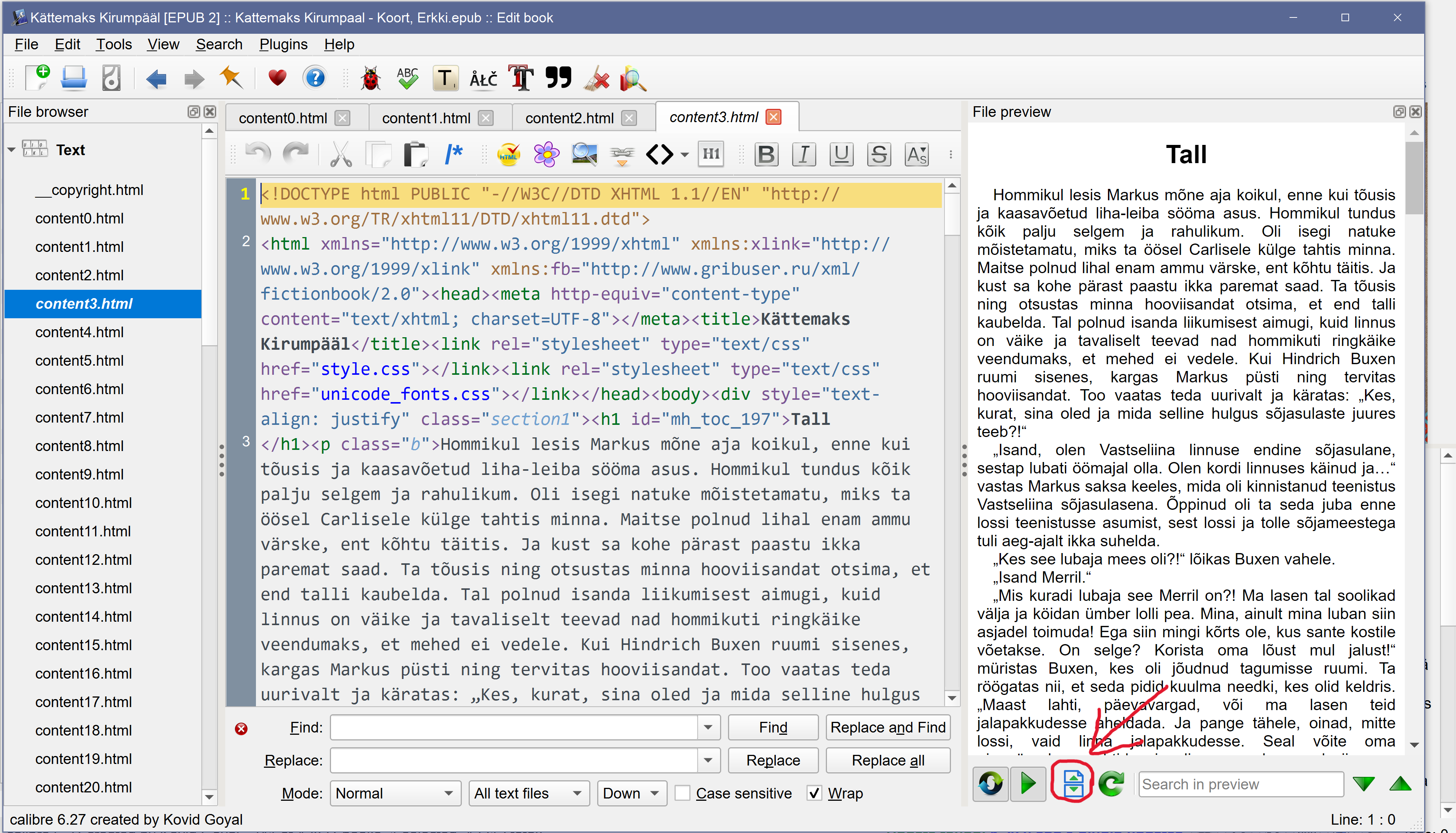

The calibre editor has a file-splitting feature.
Name:	28-10-2023 19-20-46.png

Sirtel, when I open the Calibre book editor, it does not look at all like the image you used. Are you suing another program? I don't see that icon for inserting the file split.
I took a screenshot to add to this to show you the difference, but cannot find a way to add it. When I try to, it asks for a link ?? I am using a Mac running Ventura OS if that is significant.
No, I only use the Calibre editor.
To post an image, click "Go Advanced" and then use the paperclip icon to attach your image.
The view Sirtel posted is a 'docked' view. You can also undock everything except the main (HTML) view
The VIEW menu allows you to select which items are shown.
