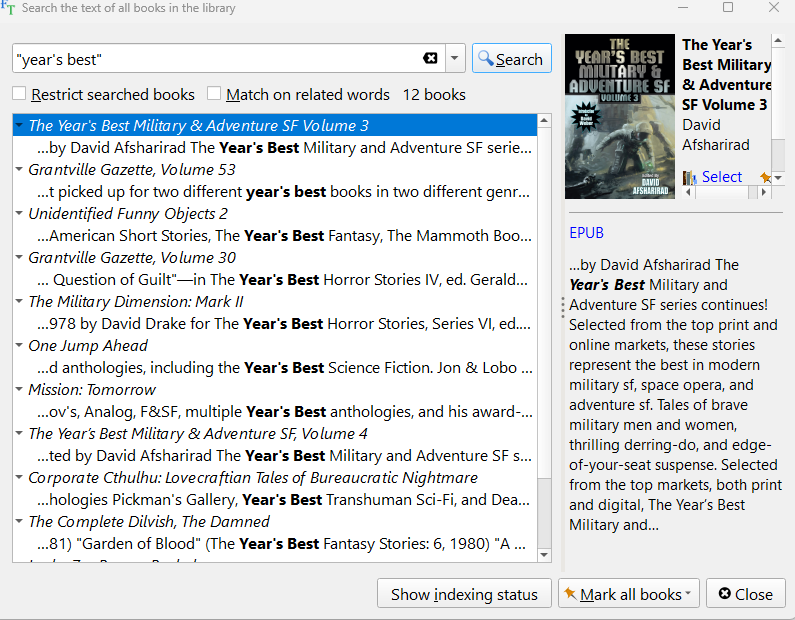

Why not enclose the search in "s ( i.e. "golfer's elbow" ). That works for me when searching for year's best for example. See attached image.

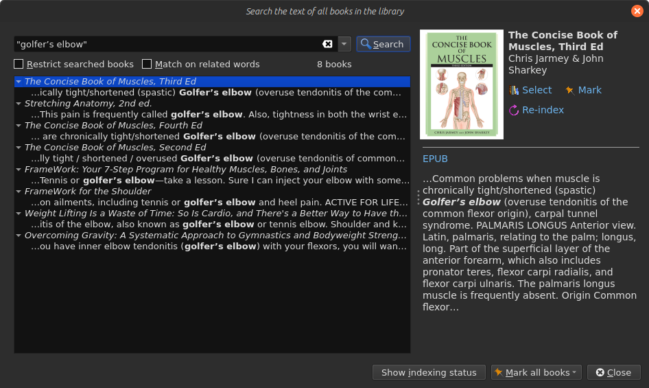

Hi Kovid,
Actually, I learned that full-text search, at least in phrases, does support punctuation. But I'm getting ahead of myself. Let's rewind.
FT Search couldn't find any books with
"golfer's elbow"
But it found eight books when it was a curly (a.k.a "smart) apostrophe, as in:
"golfers elbow"
droopy is offline   Reply With Quote

Did you turn on the option to match on related words?
No, Kovid, I did not turn it on. Please refer to screenshot of the FTS window
Name:	Screenshot from 2023-10-28 13-45-17.png

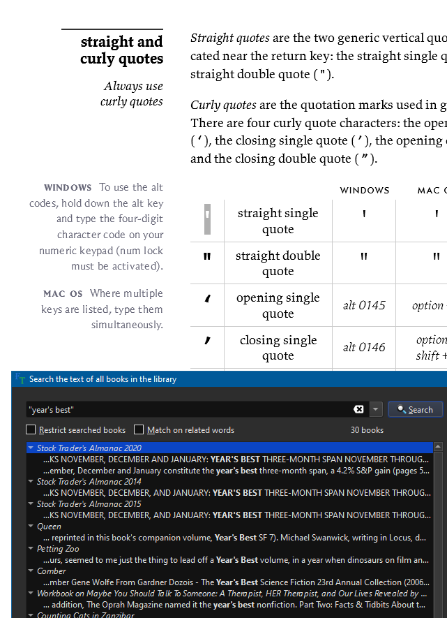

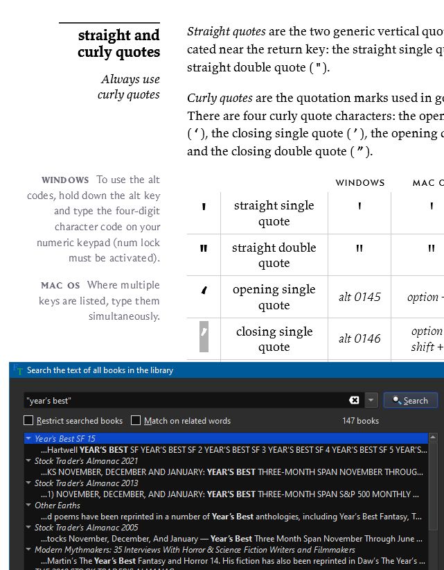

I didn't know about this typographic difference, thanks.
For what it's worth, I see a different number of results when full-text searching with each apostrophe's variant:
Name:	MWSnap 2023-10-28, 19_00_02.png
Name:	MWSnap 2023-10-28, 18_57_54.png
Could it be the case that you only have books containing results with the smart apostrophe?
Given the sqlite FTS limitation, I often find myself using the Quality Check Plugin Search ePubs tool, as it can run regex searches. For instance:
(?i)\, though\. gives me results containing the segment ", though."
Sqlite FTS can't do that, unfortunately.

Out of curiosity, I tested it this way:
FTS for "year's best" (typewriter's single quote), marked all books, tagged them with year['’]s best
FTS for "year’s best" (apostrophe), marked all books, tagged them with year['’]s best
Then I selected all tagged books and ran these queries with the Search Epubs tool:
year[']s best returned 10 results
year[’]s best returned 68 results
Final step: check if searching for year['’]s best would return the same number, and it found exactly 78 results.
I was under the impression that some books were using both forms in the same edition
