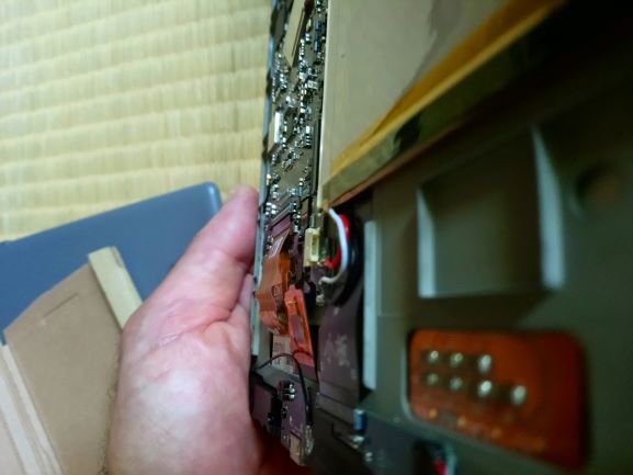

I replaced the battery in my Note PRO (hint: easy job!)
My Note Pro is 2 years old and the battery needed to be replaced. I had to charge it every night and sometime it would freeze and I had to plug back again. I like my Note Pro but it's a shame that the battery doesn't last more than 2 years.
So, I had no choice but to replace the battery. Here's the one I ordered:
https://www.aliexpress.com/item/1005...3a0b4c4duvF6jG
Its capacity is 6800 mAh compared to 4100 mAh for the original. Same physical size.
I used the following Youtube video as a base for the disassembly :
https://youtu.be/UJULjRBTiqA
Taking the Pro apart is fairly easy. If you ever took an Ipad apart (done it several times), this is 10 times EASIER. Just take your time. After you remove the 2 screws, slide a metal blade around the 2 long edges and the top, then GENTLY pry the unit apart. When you will reassemble the unit, start at the top, paying attention to the little switch.
Once apart, you need to un-solder the 3 wires. If you look at my old battery compared to the new one, you will see that the wire colors don't match. I had to use my voltmeter and compare the 2 batteries to figure out the correct wiring sequence. I solder the wires and snapped the unit together starting at the top and never using brute force, being careful not to put stress of the e-ink panel. That went quite easily. If I didn't have to figure out the correct wiring, the whole process would have taken less than 30 minutes.
Power up the unit : SUCCESS!!!!
Here are a few pictures I took during the process

Just out of curiousity:
Does the odd wire measure about 10k ohms to the minus wire?
(If you forgot to measure, measuring on the old one will be fine.)
I'm just wondering if it's a bare 10k thermistor or a data line to some chip.
Renate is online now   Reply With Quote

Got a different battery for my Note Pro. It arrived yesterday. Surprisingly, it came with a connector on it. I don't recall seeing that in the image when I ordered it.
Of course, I could take the connector off and just solder the wires in place.
However, beside where the wires for the current battery are soldered into place, there is a white plastic thing which it looks like the connector might fit into. Inside that white plastic thing, it looks like there are three pins which might fit into the connector.
What do you think? Is it to attach a battery? Or does it have some other purpose?
Have attached several pictures.

Yes, that white connector certainly looks like it is in parallel with the solder contacts.
If you have a DVM you can double check the continuity.
Before you jam in the connector, just line it up and make sure that you're happy with the sequence.

I have a Onyx Boox Note Pro and I bought few days ago on Ali Express a HSABAT 6800mAh battery it came already with connector.
I'd like to know if it works fine using the little plug on the mainboard instead of welding wires.
I will be grateful with anyone who already bought this kind of battery and share his experience.
Anyway this thread is really useful

Thanks for the fast answer, I opened the Boox with the kit supplied with the battery, cut the three wires, unglue the old battery and put the new one by plug it to the connector and I glued with the strips supplied with the battery.
After that I tried to use the ebook to see if the battery drainage was normal and slower than before, finally I closed it cautiosly.
The battery seems last pretty long
