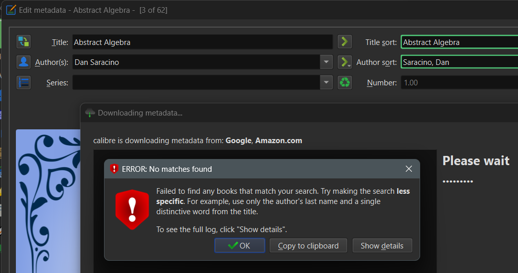

Given an ISBN, Calibre could not download metadata from amazon.com nor isbnsearch.org
I have a book with ISBN 978-9384007249 with amazon link. I used Add books > Add from ISBN but Calibre could not load any information.
Filling metadata manually does not work either.

On the other hand, the amazon link contains the detail information of the book
Similarly, the isbnsearch link contains its metadata.
Could you elaborate on how to solve this problem? I have nearly 50 books in this situation. Amazon.com and isbnsearch.org do have metadata for these isbn's but Calibre could not get it.

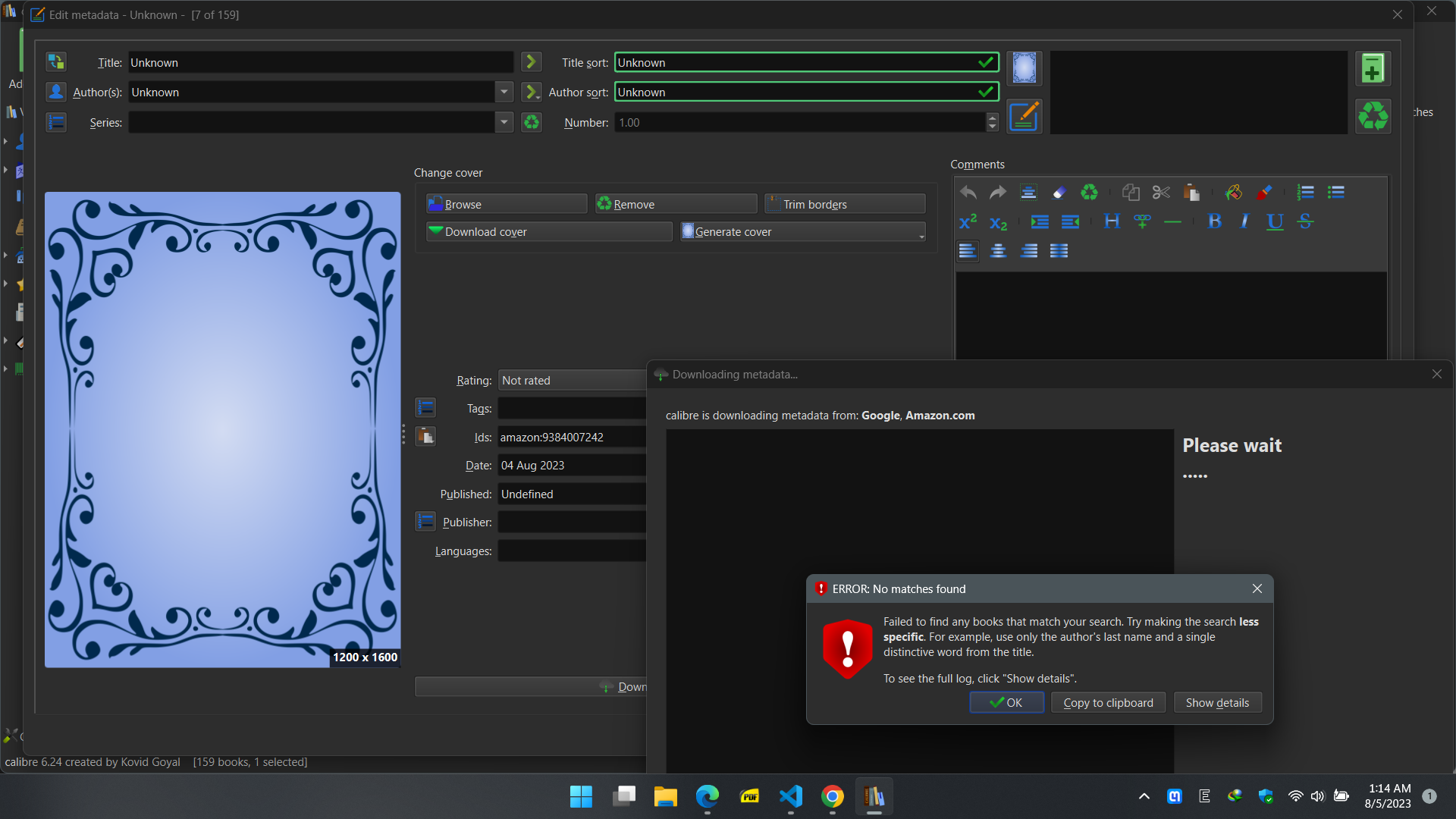

Can you use the Copy to clipboard button and post the contents here.
What if you removed the ISBN and all other data and added amazon:9384007242. I found it important that when trying to search using Amazon or ISBN ID's, that all other data fields are empty.

Unfortunately, it does not work.

The content is
calibre, version 6.24.0
ERROR: No matches found: <p>Failed to find any books that match your search. Try making the search <b>less specific</b>. For example, use only the author's last name and a single distinctive word from the title.<p>To see the full log, click "Show details".
Running identify query with parameters:
{'title': None, 'authors': None, 'identifiers': {'amazon': '9384007242'}, 'timeout': 30}
Using plugins: Google (1, 1, 1), Amazon.com (1, 3, 5)
The log from individual plugins is below
****************************** Google (1, 1, 1) ******************************
Found 0 results
Downloading from Google took 0.02988743782043457
Insufficient metadata to construct query
****************************** Amazon.com (1, 3, 5) ******************************
Found 0 results
Downloading from Amazon.com took 5.391012191772461
User-agent: Mozilla/5.0 (Windows NT 10.0; Win64; x64) AppleWebKit/537.36 (KHTML, like Gecko) Chrome/80.0.3987.87 Safari/537.36
Server: auto
Making google query: https://www.google.com/search?q=9384...www.amazon.com
Got too many requests error from Google, trying via DuckDuckGo
Making ddg query: https://duckduckgo.com/html/?q=93840...azon.com&kp=-1
Failed to find cached page for: https://www.amazon.com/Abstract-Alge.../dp/9384007242
Failed to find cached page for: https://www.amazon.com/-/zh_TW/Dan-S.../dp/9384007242
No search engine results for terms: 9384007242
No matches found with query: ['9384007242']
The identify phase took 5.49 seconds
The longest time (5.391012) was taken by: Amazon.com
Merging results from different sources
We have 0 merged results, merging took: 0.00 seconds
You might have more luck searching using an ISBN identifier instead of amazon identifier which expects an ASIN.

That is not an English language book according to the 4th digit (English is 0 or 1)
Old 08-04-2023, 09:22 PM   #9
Posts: 31,366
Karma: 62500000
Translation: You need to configure the Amazon plugin for the proper country store. The default is Amazon.com
