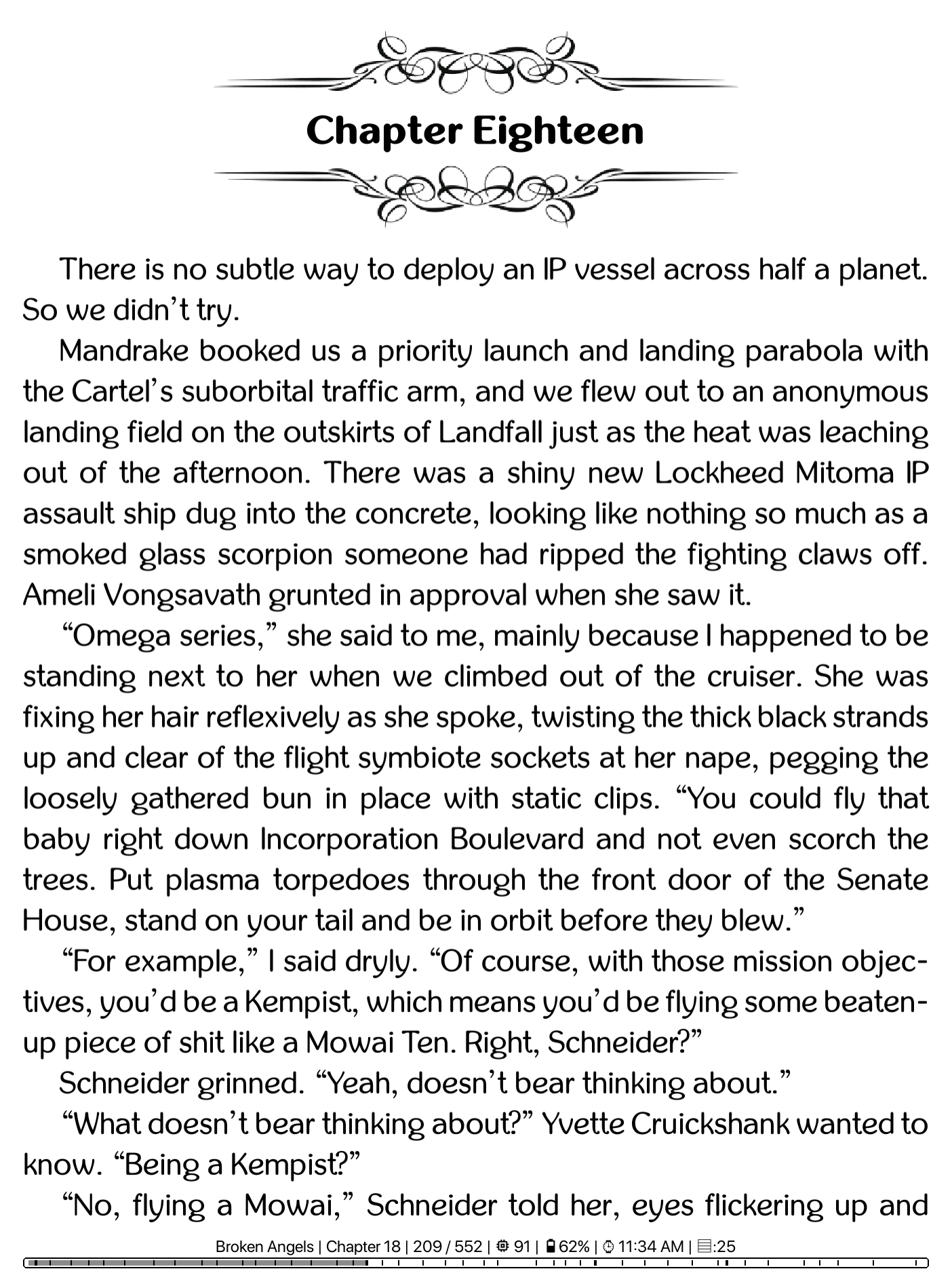

Here is the example of how it looks with 5px overscan around the screen. It just draw a black border.
KOReader shrinked down nicely, the bottom progress bar now doesn't affect the number of lines per page so much. So I was able to move its bottom margin from 1 to 5.

P.S.: “black” borders are only visible when taking screenshots. Screen itself just doesn’t start drawing most of the UI outside overscan values.
