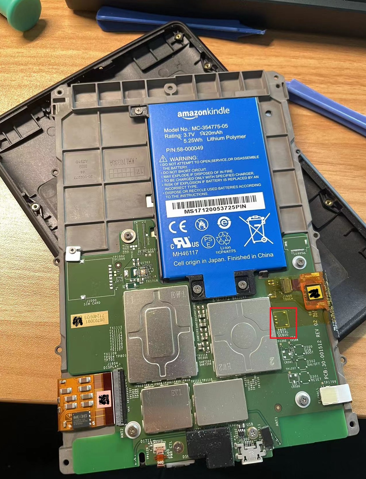

This is what I'm working at. Using USB to TTL adapter to connect via serial port-
Please help me if you know how to solve the "kinit: init not found!" issue!
Thanks,
KarZh
