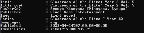

I'm looking at the command line utilities that are part of the Caliber install and I've come across an inconsistency in the metadata extracted from an epub file by Caliber and the metadata extracted from the same file by ebook-meta.
When I add the book to Caliber with the book information being read from the file not the filename I get no series information. See attachment called Snip 1.png.
When I run ebook-meta against the same file I get series information. See attachment called Snip 2.png
When I search the internal files in the epub file there is no series information.
Where is ebook-meta getting the series information that it is displaying?
Thanks

So if they both use the same code base to read metadata then there is something different elsewhere.
If I use ebook-meta on the source file (the one NOT added to Caliber) then no series info is shown, as expected.
Add this book to Caliber and the Caliber Main program shows no Series info, again as expected.
Use ebook-meta on the file in the Caliber library folder and there IS series information.
The epub file in the Caliber library and the original source file are identical according to WinMerge, and the epub file in Caliber contains no series information.
So when ebook-meta is run on the file that has been imported into Caliber where is it getting the series information from as the epub file and the opf file don't contain any series information?

After a bit of experimentation I've found that if the title of the book has a number in it and the number survives the shortening of the title when the caliber folder structure is created,
e.g. Book file is Classroom of the Elite ~ Year 2 ~ Volume 05.epub and when it is added to caliber the folder structure created is ...\tmp(ln2)\Syougo Kinugasa\Classroom of the Elite ~ Year 2 ~ v (2681) and the file is renamed to Classroom of the Elite ~ Year 2 - Syougo Kinugasa.epub.
ebook-meta returns Series : Classroom of the Elite Year #2 for the series information
In caliber if I rename the book to Classroom of the Elite ~ Year Two ~ volume 5, the folder structure becomes ...\tmp(ln2)\Syougo Kinugasa\Classroom of the Elite ~ Year Two ~ (2681) and the file is renamed Classroom of the Elite ~ Year T - Syougo Kinugasa.epub
ebook-meta returns no series information.
The OPF file in all cases contains no series information and none is stored in metadata.db

I created an empty library, added 1 book, that contains no series information in it, by dragging and dropping it. Did not change the book in any way, either in the Caliber GUI or using any other method and the behaviour I described above occurs.
I then changed the name of the book in the Caliber GUI to remove any digits, in this case remove a 2, and the behaviour I described above does not occur.
And as I said the OPF file and the Caliber database do not contain any series information.
