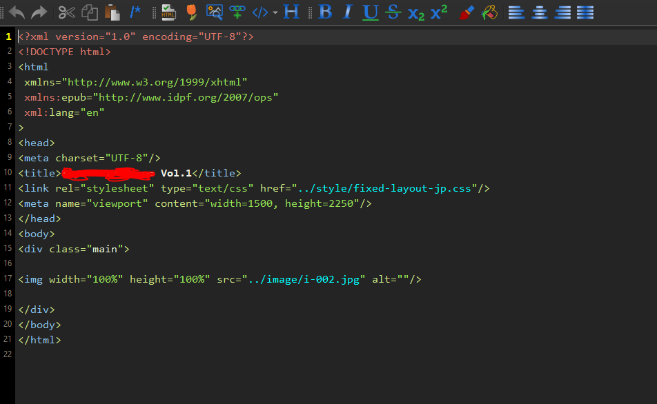

Hello. I've been trying to submit my graphic novel/comic to google play books. The software I used to export my epub was built into Clip Paint Studio. I keep getting this error when submitting to google
66: Error while parsing file: value of attribute "width" is invalid; must be an integer
66: Error while parsing file: value of attribute "height" is invalid; must be an integer
I've looked everywhere for a solution, but I can't figure out what this actually means. I've changed the image size multiple times and it still wouldn't work. the images inside the epub are 1500x2250 currently without downsizing them. Changing the EPUB 2 to a EPUB 3 allowed me to submit the work, but in testing, it included massive margins that I never put in there, shrinking the comic book images, so I can't use EPUB 3.
If anyone can guide or tell me what these errors are and how to fix them, I would appreciate it, I can't find any info anywhere about this.

Maybe you can post the code for the image.
Here you go. I'm no expert when it comes to this stuff. I sorta just pressed the export button and assumed that was all I needed to do. This is just the second pages code. None of this was made by me, all done by clip paint studio.
Is this a fixed layout eBook? If it is, go fix it to make it reflow as nobody wants fixed layout.
Also, when someone asks you to post code, post the code and not a screen grab.

I think it is complaining about the %
Is your image 1500x2250?
Try <img width="1500" height="2250"

You'll need to delete the img width and height attributes and replace them with a stylesheet reference. For more information see this post.
Sorry, but yes it is a fixed layout. Its style is "fixed-layout-jp.css". Do I need to delete it or is there something I need to replace it with? I don't think I have anything that I could replace it with, no idea where to get something like that.
Alright. Is that something I have to manually do in calibre for all 190 images? Or am I able to mass edit in some way?
My suggestion was only a bit of guesswork. You have provided only a tiny portion of the whole book. Also I have never tried to upload to Android Book Store, so I have no idea what their checker does. Sorry.
In answer to your above question, it depends. If the images are all the same at 1500x2250, then it should be pretty easy to fix the image code with a regex. If you have many different sizes, you will need to do a fix for each different size.
Are you using Calibre or Sigil? Have you run the EpubCheck and native Check Book to check your ebook? Do this first. Once you find the errors using this method, you can then explore ways to fix them, either using the method by @Doitsu or my suggestion above. Once all the errors are fixed, you can try uploading again.

Originally Posted by Cyberseeker View Post
My width value said width="50%" So, whats wrong with that? Doesn't epub like percentages?
If the ebook is reflowable, passes epub check [...]
The OP's book failed EPUBCheck because it's an epub3 book and the <img> tags had with and height attributes with percentage values, which aren't allowed in HTML5.
