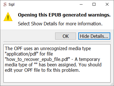

Hello.
Added a pdf document to ePub.
Now, when opening a book, the editor issues a warning about an unknown type.
Sigil doesn't understand basic MIME types?
How to fix it?
If you do not pay attention to this warning and a reminder to save the file, then everything works.
You'll need to create a fallback item. For more information see this post.
Unfortunately, the current Sigil version doesn't support application/pdf and won't display the fallback .xhtml page.

Unfortunately, that was 2009 and even by 2015 fallbacks were still not accepted by most epub reading systems.
See this epubcheck issue post from 2015 for example:
https://github.com/w3c/epubcheck/issues/511
And as pointed out, fallbacks are a feature of the e-reader and not Sigil. It is up to the e-reading system to decide if and how to handle fallbacks. As a design tool, Sigil should allow the user to create fallbacks that must then be tested on multiple e-readers.
Sigil supports all epub3 core media types. But application/pdf is not a epub3 core media type and so is not guaranteed to be supported by epub e-readers.
I could add support for recognizing the application/pdf mime type in Sigil, but given the horrendous state of e-reader fallback support and all of the issues Jelby mentioned, it would be a real mistake for anyone to use it for a commercial epub.
Not even all browser engines support pdf without additional plugins.
I will at least change Sigil to not replace it but frankly embedding a pdf inside an epub is not a good idea (IMHO). Contrary to public opinion an epub is not a website just rolled into a zip and never should be.

Added support for recognition of "application/pdf" as a valid media type has been pushed to Sigil master. The only way to truly work with an internal pdf in Sigil is to use the OpenWith menu on it in BookBrowser and choose an external pdf editor/viewer.
And as the spec says you need to add a manifest fallback using xhtml/svg so your epub can be used in epub spec compliant e-readers that will most likely not support internal pdfs.
