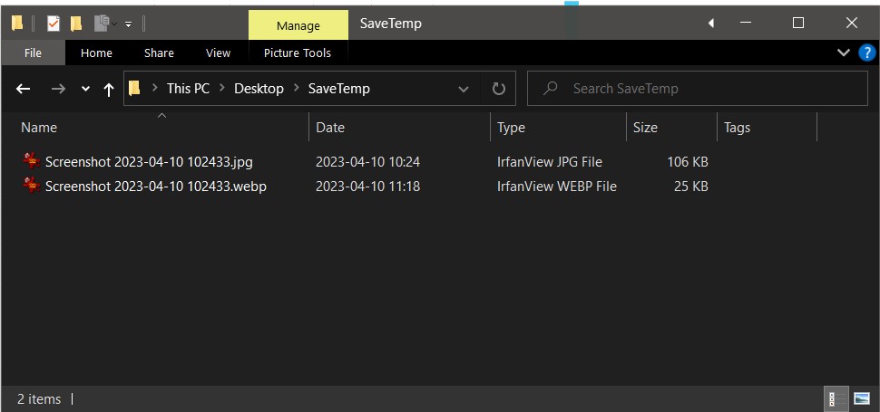

Originally Posted by kevn57 View Post
If Calibre can't do it does anyone know of other software I might d/l to do it?
On Windows IrfanView, viz:
Name:	Screenshot 2023-04-10 112232.jpg

Thanks BetterRed, I know how to convert the images, but then the HTML needs to be edited, I can do it by hand but I have a lot Light Novels that take up a lot of space I was looking for something then can convert images and also update the appropriate files to change the links from ex. pic1.jpg to pic1.webp

Just rename all the files in the calibre editor to webp. It will change the links for you. Then use the unpack book tool to replace the renamed files with actual webp images using whatever tool you like.
Thanks that's just exactly what I wanted.
