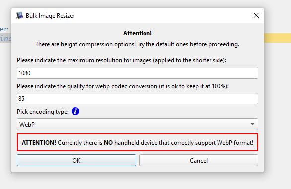

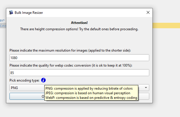

Since I was touching it, I added picker for output conversion (JPEG, PNG, WebP)

I would leave the capability to convert to WebP but with a warning
Yep I already did that.
ID:	207831   Click image for larger version
