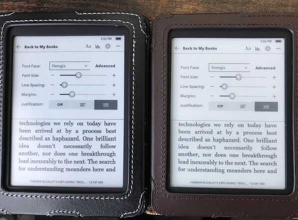

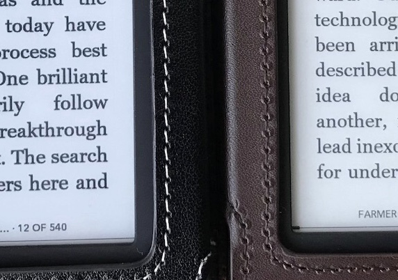

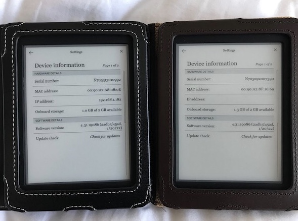

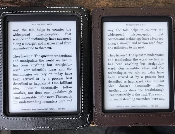

I bought 2 Kobo Mini’s off eBay recently, installed the Kobo Glo’s firmware (4.31.19086) on them so that they still can sync with overdrive loans etc following Kobo’s decision to removal support for them as senior citizens etc.
One thing I didn’t realise was that Kobo must of changed supply of the screen during the later manufactures, because there is a noticeable difference in screen contrast (blacker rather than dark grey e-ink) between these 2 units.
The older Kobo Mini unit N705292007390 has the less contrasting, almost fuzzier screen.
The newer Kobo Mini unit N705313010992 has the better contrast, much sharper screen.
You can see the difference in the photos.
Has anyone else with a Kobo Mini (still) noticed this?

The font weight looks different to me. Are the settings the exact same?
Yes, I definitely noticed it. I recently bought a Kobo Mini (and replaced the battery) and its screen is like your newer one. The other two Kobo Minis that I still have, have the grey lettering (like your older Mini) and much poorer contrast.
The new one's serial number is N705313016045
The old one's serial numbers are N705293017092
. ..................................and... N7052A2005101
The two old ones are definitely "muddier."

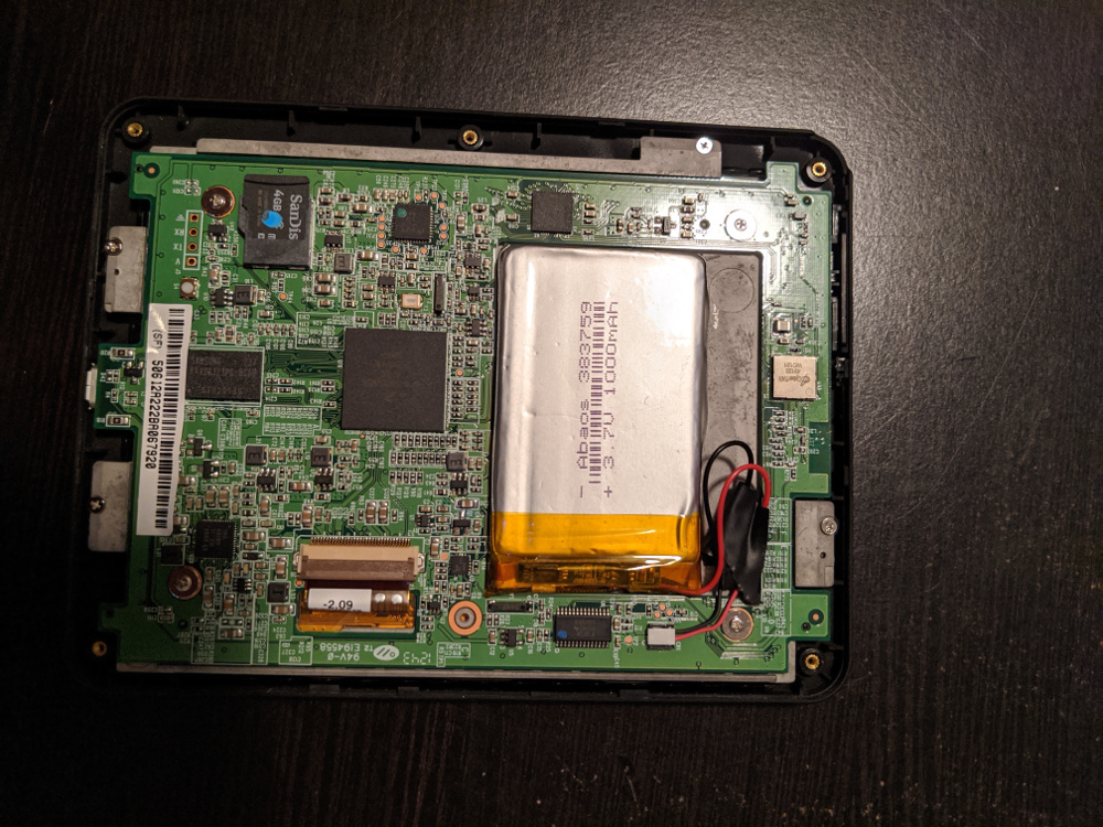

I have also taken the snapback cover off and unscrewed the back covers. The older unit had the factory fitted 2GB Micro SD card, the newer unit had the factory fitted 4GB Micro SD (though 2GB of those 4GB are not user accessible unless you re-partition that card).
So i’m wondering if the improved blacker display screen models were only the ones that also contained the factory fitted 4GB micro SD inside?

I can confirm that my newer Kobo Mini has the 4GB microSD card. I took it apart to replace the battery and posted pictures here...
https://www.mobileread.com/forums/sh...d.php?t=342614
I haven't taken the other Minis apart as (so far) I haven't had to replace their batteries. But I'm guessing I would find 2 GB microSD cards.
I've attached one of the pictures from the battery replacement thread (the one that shows the microSD card.

I have found this too, but have never found any information on it, other than a general discussion about whether the screen was vizplex or pearl, maybe they changed to pearl?
