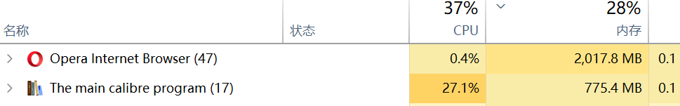

epub to PDF, the cpu ratio is particularly large, easy to system blue screen, please help to see, thank you!
Name:	屏幕截图 2022-12-20 204133.png

As shown in the figure, opera occupies a small cpu, the total memory of 32g, should be enough
