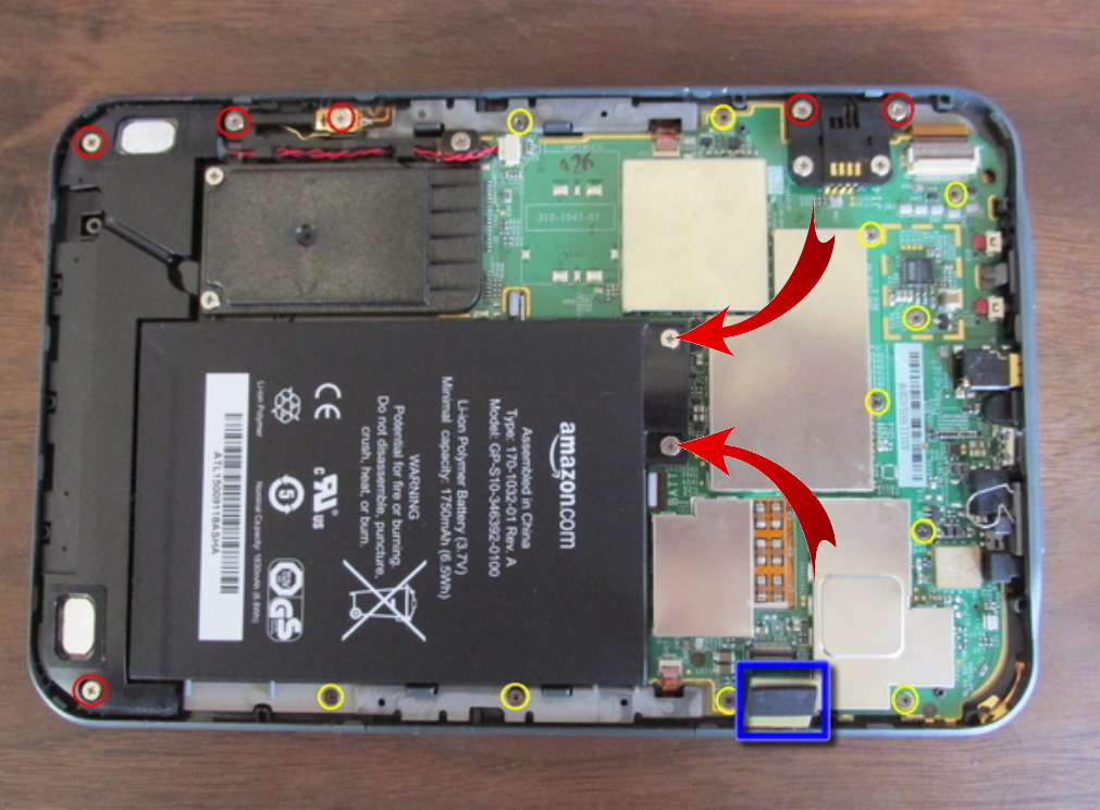

Originally Posted by tm3 View Post
rolgiati, have you ever replaced a K3 battery? I still love my K3 but the battery is going and I may tackle trying to replace it.
Easy to do once you have opened the case (I use my thumb-nails as the main case-opening tools) just the two silver-coloured screws I marked with red arrows on the shamelessly stolen picture hold the battery.
Those marked with red and yellow circles are those to remove to change the screen.
