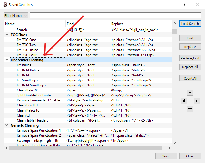

You can go to:
  • Tools > Saved Searches
You then can add a big list of commonly used Find/Replaces:
Name         | Find                              | Replace
Fix Italics  | <span style="font-style:italic;"> | <span class="italics">
Fix Bold     | <span style="font-weight:bold;">  | <span class="bold">
To make it easier, you can also organize them into "Groups".
Why use Groups? Well, another fantastic trick is:
Find/Replace An Entire Group Of Searches In One Press
1. Click on the bold Group name:
2. Press "Replace All".
Sigil will now go through and run every single Find/Replace.
You have 12 Find/Replaces in that group?
Sigil will run all 12... one right after the other... doing all those steps in a split second.
