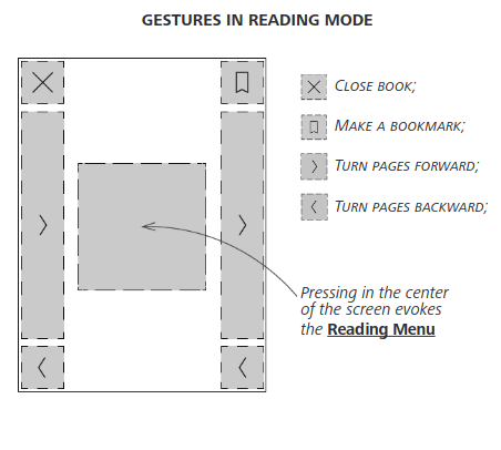

So I have a Touch HD 3, but I'm struggling with the built-in reader because for some reason every few pages when I try to go forward a page it glitches and makes the pages go backward.
I used to have this issue too, when using the touchscreen (I normally use the buttons). It may be that you were doing what I was doing, assuming the left side was "back" and the right side was "forward." Here's a page from the manual. What I was doing was tapping near the bottom to go forward, going backwards instead. (See attachment)
I think the little "backward" tap zones are actually bigger (go higher) that what they show here. This is kind of a pain when go back and forth between different readers.
