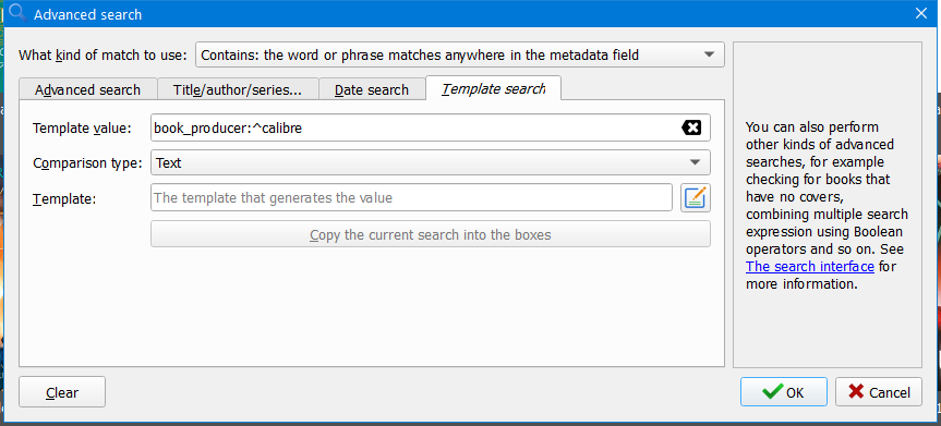

I'd like to do a template search for """book_producer""" containing "^calibre" with (formats:#=1 and formats: pdf). As shown in Calibre manual, that publication metadata field is available:

Screenshot below shows what I tried, but that was just guesswork:

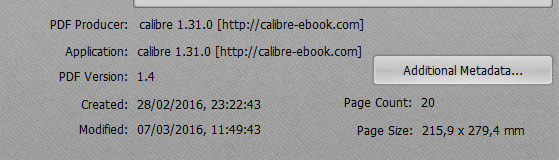

I can retrieve its value from CLI, with ebook-meta. Most pdf files have a value set:
Name:	MWSnap0846 2022-10-16, 14_45_41.png
I have attached pics showing the values I'd like to filter, and two pdf files that contain the book-producer value.
