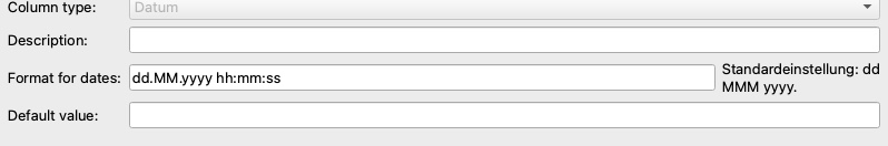

I can confirm that certain rows dont get updated instantly (using external plugins), but normally if i do something in the library (open a book, add a new book or whatever), the affected rows get updated.
I dont use emblems, so this "problem" could be something different.
Maybe your row #lastopened is "malformed": Look inside the row settings, if that row only contains the date without hour, the row only gets updated once a day...
My setting is german view, set yours according your language

Ok, some silly question: What kind of value is your #lastopened? Is it of type date? Then your rule is wrong! is set expects a yes/no, but if its a date in this field, your rule has to fail! I tested this here.
When its date you should change to whatever has to do with date/time-settings. The only one which works is "not set". It applies when no date is set.
My faulty first answer, i should have looked better to your pic...
Sorry!
Hope that helps

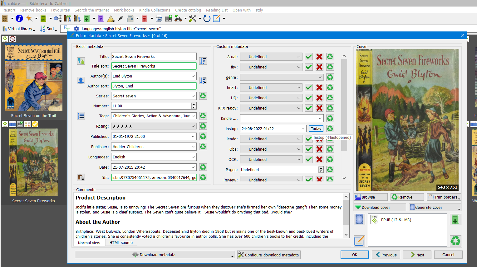

Is this happening only when the value is changed using a plugin or when using the edit metadata dialog as well? If its the former, its a bug in the plugin, the plugin must call refresh_ids() after making a change to ensure things are updated.
Old 08-24-2022, 01:44 AM   #9
Comfy.n
want to learn what I want
Posts: 1,710
Karma: 7917125
Join Date: Sep 2020
Hi, Kovid, thanks again for all your work!
Well... I just tested that here, by changing the custom column #lastopened on the Edit Metadata dialog to "today" and the emblem showed up instantly! (I have attached a screenshot)
That indeed indicates a bug in the plugins. I'm using this one, called Auto Datestamp and View. Is there some quick fix I can apply to it? I'm no coder, but sometimes I customise plugins and browser extensions for personal use.
Here is the code of Auto Datestamp and View:

BTW, I tried Job Spy Plugin similar functionality, but the emblem would not update either.
