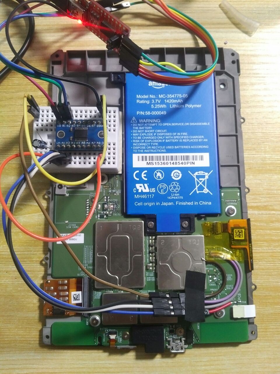

As I replied in other posts, my PW3 updated to 5.14.3.0.1 automatically and the jailbreak is gone. So I decided to follow this post to do a serial jailbreak.
Everything worked as expected until I tried to execute the jailbreak script. I copied everything inside kindle-5.4-jailbreak.zip in kindle-jailbreak-1.16.N-r18869.tar into root directory of Kindle. And I got the follow error.
[root@kindle us]# sh jb.sh
info jb_install:mount_root_rw:: Mounting rootfs rw
info jb_install:install_update_key:: Copying the jailbreak updater key
info jb_install:install_fw54_exec_userstore_flag:: Creating the userstore exec flag file
info jb_install:install_bridge:: Installing the jailbreak bridge
info jb_install:install:: Setting up MKK persistent copy
info jb_install:install:: Setting up RP persistent copy
update_to_display: update_mode=PARTIAL, wave_mode=257 inverted=0
swipe feature is not supported in this platfom G1
Does this mean the patch is incompatible with the new firmware? Or I did something wrong?
Thanks.

Don't know how to modify or delete the post, but it seems that the script did manage to do it's job and the jailbreak is back online after waiting for long enough time. KUAL and MRPI works as expected.
Thanks again for great guides in mobileread.
