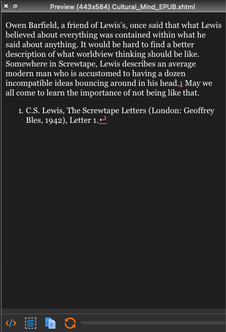

I'm very sure Tex'll have a much better solution than this one, but I figured I'd come back anyway since I said I would. If you try any of this, please save a copy first in case something breaks.
Leaving the body text part alone, since that part seemed ok, I'd try this in that footnotes section. I'd first fix the broken backlink with this regex search:
Find
(<a class="_idFootnoteAnchor.*?>)(</a>)(.*?)(</p>)
Replace
\3\1↩\2\4
Basically moving the note contents ahead of the empty <a>, and filling the <a>with a back arrow. Then, to get the numbers back, I'd start with something like:
Find
<div class="_idFootnotes">
Replace
<ol class="_idFootnotes">
Find
</aside>\n</div></body>
Replace
</aside>\n</ol></body>
That'd change the parent <div> to an <ol>. Note that you'll have to also adjust this in CSS, because InDesign will likely have it in there as div._idFootnotes. If so, you'll have to edit it to ol._idFootnotes, or probably just ._idFootnotes.
After that, I'd do this:
Find
<aside (id="footnote-\d{1,}")
Replace
<li \1
Find
↩</a></p>\n</aside>
Replace
↩</a></p>\n</li>
You'll have to go back into the CSS again with that to change aside._idFootnote to li._idFootnote, or just ._idFootnote. I attached the basic result, note that I did not bother setting any CSS up here. Again, I wouldn't do it this way unless you can't find a better solution, and I'm sure there is one.
Name:	Screen Shot 2022-06-03 at 3.47.23 PM.png

  • "#footnote-025" in the HTML = the actual footnote 24
Rough Solution #2: You could use Doitsu's "Incremental IDs" plugin.
1. Renumber all the IDs to match whatever ## the book displays.
2. Get those numbers into the text itself.
I can't recall seeing much thorough testing on <ol> footnotes.
Does anyone know how well this works across devices? (Especially older ones?)
In EPUBs, I always avoided <ol> for lists because of:
  • All the auto-numbering issues.
    • Starting from non-1 numbers.
    • Different alphabets.
    • What happens when you get a '*' footnote?
  • Not being able to handle complicated numbering/formatting schemes.
A lot of that stuff may work on the web, where you have many more updated browsers... but in the land of ebooks, that kind of complicated code would be... extremely unreliable.
This why people like me + Hitch always recommend inserting the numbers into the text itself. It's the only reliable way to get it working 100% across all devices/formats.
For more info, see lots of the discussion in:
where I picked apart Google Docs's <ol> footnote abominations.
Side Note #2: If you want even more fun with complicated footnotes/endnotes, see the discussion where I broke down a Winston Churchill ebook:
The beast had ~5000 endnotes and ~300 footnotes.
Endnotes were displayed as "1" and footnotes were displayed as "fn1".
It's definitely one of those complicated examples where Print book numbering ≠ Ebook.
Side Note #2.1: I also wonder how <ol> would handle that when it starts reaching 5000!!! lol.
Yep, probably just some fiddly setting in InDesign.
That's where I would look first.
One of those checkboxes we mentioned may fix this numbering oddity.
Side Note: Personally, for my footnotes, I just throw away all the InDesign crap and redo everything to human-readable, clean stuff. :P
