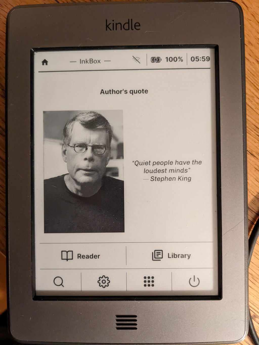

Though, I did make some general progress...
