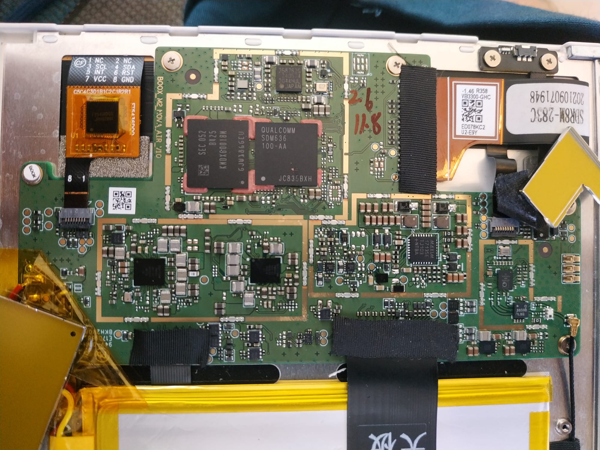

Edit - disassembled, any idea which are the edl test points?

I'm sorry to say that nothing looks that conspicuous on the board.
Is there something on the back cover that receives those 3 springs?
If there is nothing on the back cover it could be UART test points, but that seems unusual.
You might try a photo of just the board on the left. Maybe two separate photos.
I wouldn't go around indiscriminately shorting any points, you could do damage.
OTOH, if you have a voltmeter you can measure the voltage on the points in the photo versus ground (like the tin shields).
Edit: I'm thinking those springs are to another antenna on the back cover.

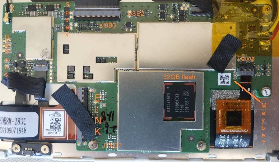

Edit - added photo

Can you still get to fastboot? If you can, "fastboot erase misc".
Can you measure voltages on the two "maybe?" points.
Maybe one is 1.8V and the other is smallish 0.2V but not 0.000?
Are the "tin cans" one part, soldered to the board or are they a soldered-in base and a top that snaps on with little "dimples".
Do you have resistors?
If it won't turn off, keep this charged.

Edit - added photo with tin cans removed

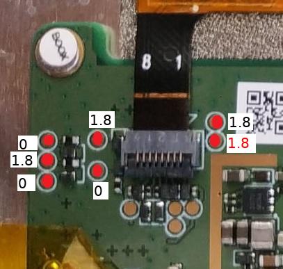

Grrr, can't get into Fastboot isn't good.
Check the two pairs of red dots for same 1.8/0.2 criteria.
Look at the triple red dot for 1.8V/???/0.000.
Oops, I forgot, my Poke3 (SDM636) has 1.8V UART (for the triple)

Theses are the measured voltages, no 0.2V,
The one labeled in red is a little higher than the others, by about 20-30mV

Do you solder? Do you have some electronic junk?
Can you find a 300-1000 ohm resistor and solder some wires to it so that you could use it?
If you find a resistor, you can try doing a reset with the resistor between the 1.8V and 0V in the middle. If you have enough hands/test clips you can see when you use the resistor whether the 1.8V goes down or the 0V goes up. (The 0V should go up to 1.8V)
(You can do that measurement without doing the reset. Of course you need to do the reset to actually see if it will work.)
Have you already checked if an EDL cable works? I've never had any luck, but maybe if your Nova Air does not have analog audio over Type C it could work.
I presume that you don't have an oscilloscope.
A USB UART would be great, but you need a 1.8V one, not the typical 3.3V one.
If you do decide that you want one, this looks pretty good:
https://www.amazon.com/jim-sh-Micro1.../dp/B076B9YRMP
I'm not guaranteeing that we're going to find the hardware console and that you can use the UART.
If we can't find the EDL point, we're going to have to try to prevent the SoC from reading the flash so that it throws up its hands and goes to EDL. I've gotten my Moto E6 to EDL that way.
Edit: Actually, this is kind of cuter and works on 4 different voltage levels.
https://www.amazon.com/DSD-TECH-SH-U...dp/B07WX2DSVB/
Don't buy anything with Prolific 2303 in it. Buy from reputable supplier of FTDI.

I'll try to find/make an edl cable. If that doesn't work I think I'll try the warranty, though at my old lab they probably have some resistors and even oscilloscopes so I can say hi and try that as well.
nivieru is offline   Reply With Quote
