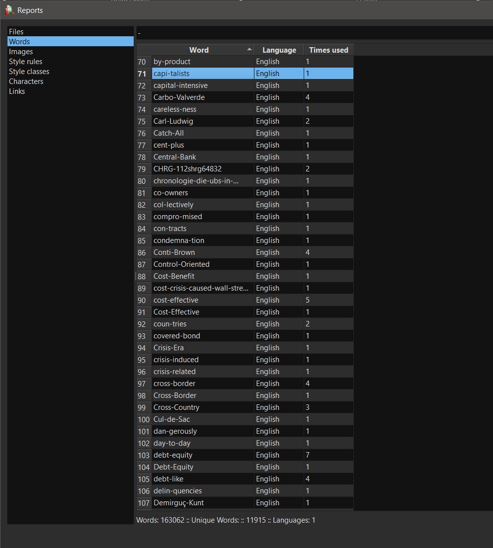

I would use the Editor's Tools->Reports->Words list with a '-' in the filter, it should be easy to spot any questionable hyphenation, and fix in the code editor, viz:
Name:	Screenshot 2021-01-22 074435.jpg
