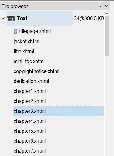

Since you already posted in the Calibre Editor sub-forum.
you could just Move the files placement order (up or down)in the File Browser (a window in the Editor).
Just drag the highlighted piece to its proper (order) place.
This assumes you did not use the term MERGE to mean make a huge section file in the book out of each (FF) piece you added (inserted into the book)There is absolutely no reason for EPUB/AZW* files to be made from a single huge file (inside). The Editor S&R scope setting can determine what files are operated upon). If you did make a huge file out of piece, ask if you need help using the Editors (not to be confused with the plugin the splits books) Split function
The TOC editor tool, allows the TOC to adjusted any order / indent you see fit

Assuming, as theducks said, that each chapter is its own file, and assuming that you have the books in epub or azw3, what I would do is:
1. Take the 15-chapter sub-book, open in editor, and highlight the 15 chapter files, then export them (right-click the selection, then export).
2. Open the main big book, and Menu-->File-->Import files into book. Point to your 15 exported files.
3. Drag the files from the bottom of the list, where they will appear, to where you want them among the original chapters.
4. Check that they look OK in the preview. If they don't, the books probably have different styling, css, etc. You can fix that, maybe import the smaller book's css file. This could be no problem or a big deal, depending on the books.
5. Use the ToC editor to do whatever you want with the new files in the ToC. Add them to the ToC and call them whatever you like.
(If the chapters are not in single files, your best bet is to split them up to make it so before you start. Or just deal with chapters as headings in huge files--ugh.)
