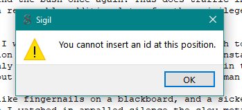

Something that has been puzzling me for some time is the rule regarding the placement of Ids and Links.
I am in the process of adding some footnotes to a book that has existing footnotes. A percentage of the existing footnote links are at the end of paragraphs, situated between the period and the paragraph ending tag (.{link}</p>) as you can see in this example
If I try to add a new ID or link in a similar position I get the error message
If I move the cursor to the left of the period ({link}.</p>) then it works OK. The odd thing is that having created the ID or Link I can move the period to the left of the link and all is fine.
So why can't I create it there in the first place as it appears to be a valid location?
ID:	192793   Click image for larger version

The highlighted text start is just before the < of the a tag, that is not a valid location to insert an id. Why did you select a section of text instead of just placing the cursor after the "a" anyplace and asking to insert an id? Or is that "<a" selected/highlighted for some other reason?
Any cursor point anyplace inside the < to > and after tag name should work, just not before. If that does not work, it is a bug.

I think I have confused you, Kevin. The image of the link was just to show an example of an existing link situated between the period and the <.
I was not trying to insert a new link at that point, and the only reason it's highlighted is because I was using a search to find an example to show.
As Turtle91 points out, it seems that if you try to insert an ID, link or image between a period and </p> Sigil wont let you despite it appearing to be a valid location.
.(ID/Link/Image)</p> - Not allowed
.(ID/Link/Image)[any character]</p> - Allowed
Create (ID, Link or Image) and delete [any character] - Allowed
Does that make sense?

Yes. The issue is even though the cursor shows "after" the period but "before" the < of the ending p tag, according to Qt the character under the cursor is in fact the "<" which is not a valid location.
I will have to add code to special case this for all the various things inserted. The best workaround is add a space after the period and place the cursor before the space if you want to insert a link before the ending p tag.

Actually, I just tested this with Sigil-1.9.2 and here is what I am seeing:
Insert ID - adds an attribute id="blah" to a single or opening tag. It works as expected. If the insertion point is anywhere after the tag name even just before the ending ">".
Insert File (Image or Media) - adds an img, video, or audio tag and it must be outside of opening or closing tags and it appears to work as expected.
That said
Insert Link - adds an anchor tag if needed and sets the href to the selected destination.
It must be added outside of opening and closing tags or in an existing anchor tag. This one has an issue with the cursor right before the start of an tag (ending </p>) and it needs the workaround.
You should be seeing the same thing. Please let me know if you are not just in case I am missing something in my testing.

This is what I see with 1.9.2.
Insert ID - works anywhere apart from immediately before or within a closing tag.
Insert image - works as expected apart from within the opening and closing tags.
Insert Link - works anywhere apart from inside opening or closing tags and immediately before a closing tag.

Yes, Insert ID adds an id attribute and those can only be added to opening or single tags so that is correct. Insert File is correct as well I think.
The only problem is in Insert link.

If I am reading you correctly, you are saying that Insert ID works for you immediately before a closing tag?
If that is so, then I am not seeing that.

It has two modes.
The first mode adds an id attribute to an existing block level tag.
So the cursor must be inside an opening tag not in a closing tag or in text.
So it works for me here (where the cursor is represented by the | char)
<p|>
If you instead select some text, it will use the second mode and will wrap an anchor a tag around the selected text and then put the id attribute on that anchor tag.
If we let [ ] indicate the highlighted text, then the following works just fine:
<p>This is a piece of [text.]</p>
(so the word "text." is selected and highlighted), it will produce the following assuming I want to add the id "jjj":
<p>This is a piece of <a id="jjj">text.</a></p>
There may be other modes to how people use it that I know nothing about (unfortunately).
Both of these modes seem to work perfectly in my testing.
So just to be clear how do you typically use it. I may learn something here!
The only bug I see is that it even works (incorrectly) in self-closing tags:
<hr|/>
Is that what you are seeing?

I confirm that what you have outlined below works for me too.
But, and this is where we differ, you are highlighting existing text and applying an ID or link to that, whereas I am trying to insert an ID without anything selected.
<p>This is a piece of [text.]</p> - highlighting [text.] clicking Insert ID works as it should.
<p>This is a piece of text.↨</p> (where ↨ represents the cursor) clicking Insert ID generates the error message.
<p>This is a piece of text.↨ </p> clicking Insert ID works as it should.
I think this must be what you said earlier about QT is referencing one character to the right and not the cursor position.

Okay, I never thought to use it to add an empty anchor. Once I tried that it did fail. I will look into it.

No problems. Both InsertId and InsertLink now work when cursor immediately before an ending tag |</tag>. InsertFile already worked in that position.
This fix has been pushed to master and will appear in the next release.
