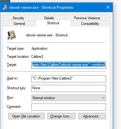

Old 03-12-2022, 09:20 PM   #5
Posts: 45,724
Karma: 28549306
In your shortcut add the --continue option to the command line
Old 03-12-2022, 09:21 PM   #6
Can you be a bit more specific please? No clue how to do that??

Old 03-12-2022, 11:03 PM   #9
Posts: 31,371
Karma: 62500000
picture worth many words

Old 03-13-2022, 03:22 PM   #11
tym
tym can name that ebook in five wordstym can name that ebook in five wordstym can name that ebook in five wordstym can name that ebook in five wordstym can name that ebook in five wordstym can name that ebook in five wordstym can name that ebook in five wordstym can name that ebook in five wordstym can name that ebook in five wordstym can name that ebook in five wordstym can name that ebook in five words
Posts: 77
Karma: 37732
Join Date: Jan 2012
Device: nook touch
Thank you so very very much. It worked great. I didnt realize there was a space before --continue.
