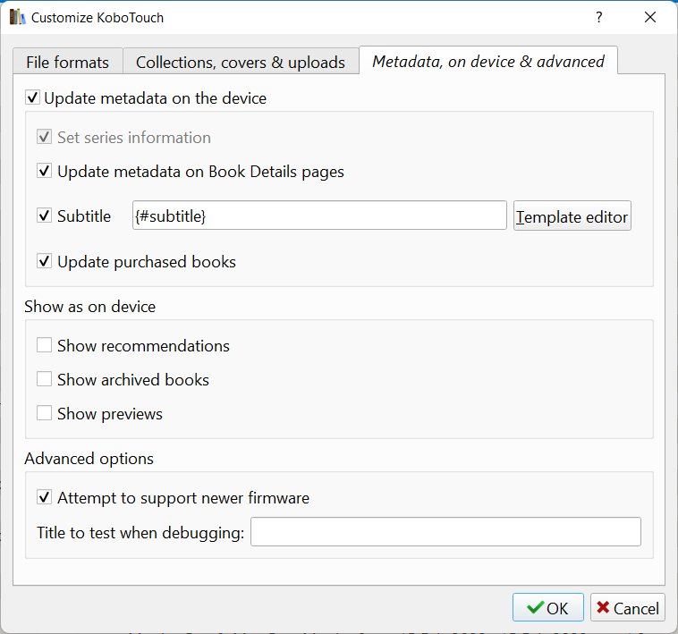

I get the unsupported version error in calibre have not updated it since i updated my Kobo and still able to sideload books to ereader in calibre but cant manage the collection whilst plugged in. Not an issue for me

You can try enabling the Attempt to support newer firmware option in the 3rd tab of the KoboTouch/KoboTouchExtended driver configuration.
