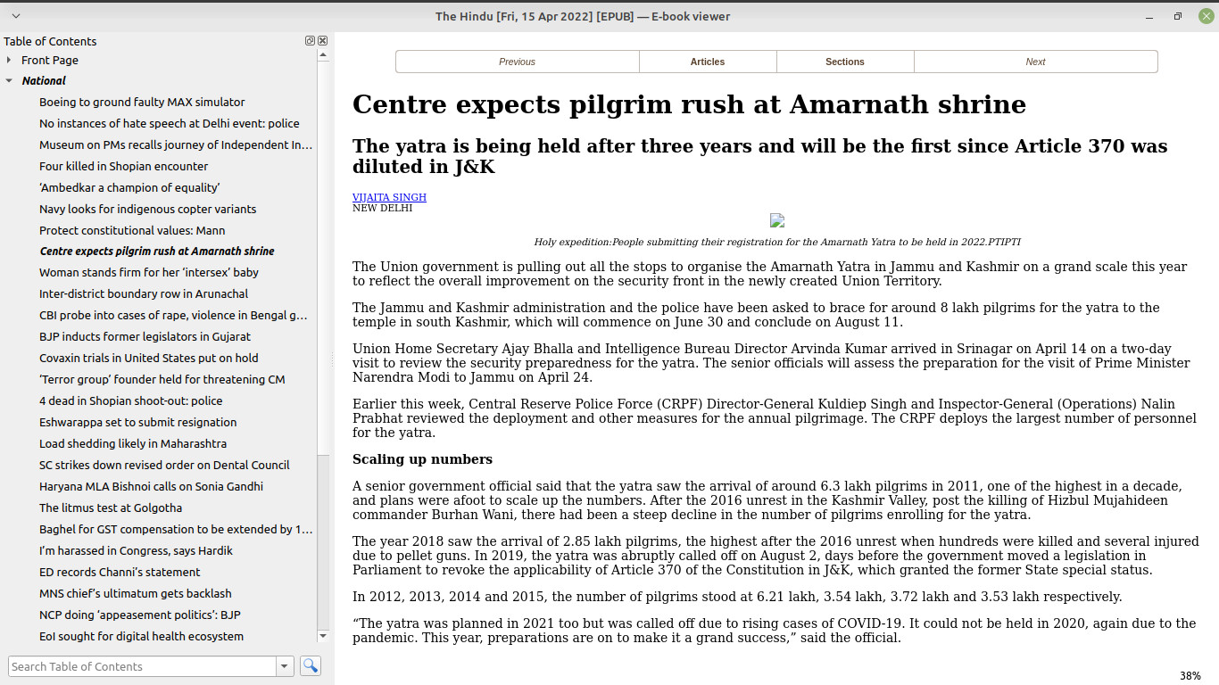

The hindu recipe is omitting pictures
Saw some previous posts similar to this but the mentioned code for the recipe has changed from the current one.
So how do i fix it?
[IMG]file:///mnt/EE16FB6F16FB3765/Downloads/Screenshot_2022-04-15_12-19-44.png[/IMG]
My 2nd issue is that while the structure of articles is correct in calibre e reader but reading the list of articles (list only, not the article itself) appears without line breaks.
How do i fix it?
i read on librera reader for android

this is the image i was trying to attach in original post

https://github.com/kovidgoyal/calibr...s/hindu.recipe
they went back again.. should remove recently added lines 58, 59
thanks for the help.removing those lines from the codes fixes the issue partly. While some articles now have images in them but the other articles have blank spaces in place of photo where it should be and instead the required photo flashes for a oment while navigating through the pages and then disappears.
and is there any fix for the second part of the original post that talked about line breaks?
