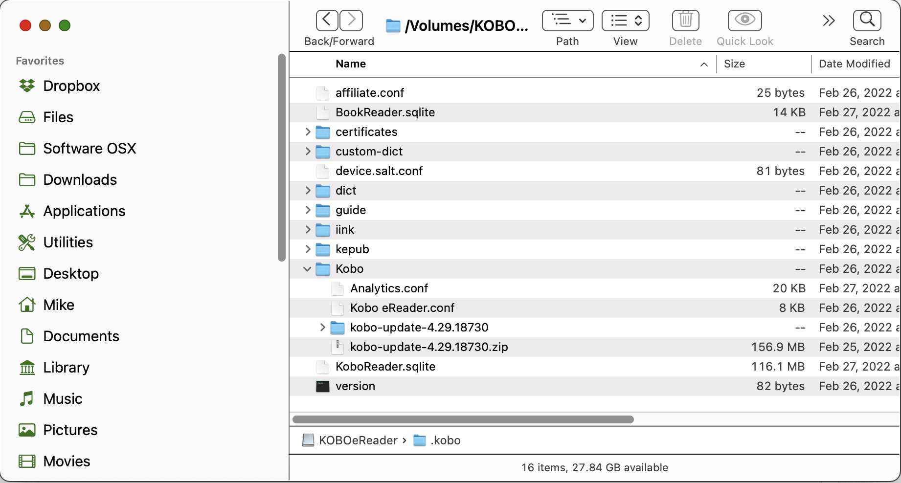

Thanks for the help.I tried the Kobo desktop application and it basically forced me to either open WiFi or download the files via the web. Could not find a way to replace the firmware update. Attached is a screenshot of my /Volumes/KOBOeReader/.kobo folder. Did I insert the 4.30 update files in the correct place? Restarting with WiFi and Bluetooth off and and updates disallowed in the preferences still results in booting into 4.31

Just like doing the setup over WiFi, the desktop application will download the currently available firmware for you. Just let it. After it has finished, it will start downloading books, you can skip that if you want. When it prompts to eject the device, don't.
Look on the device in the directory ".kobo". You will find two files, "KoboRoot.tgz" and "manifest.md5sum", and a directory, "upgrade". Replace these with the files and directory from the firmware package for the version you want to use.
