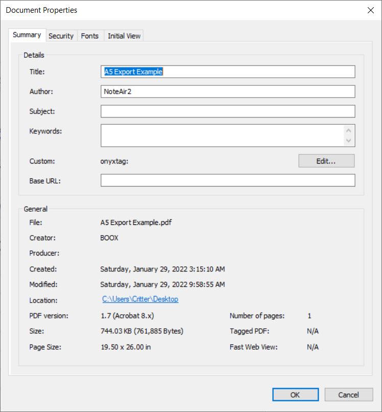

Hi Yokos, I should have been more specific. It's not the file size that is the problem, I'm happy with the rasterized file. It's the physical size. When I add a note's pdf export to an existing pdf document the new page (from Note2) is five times as big. My existing pages are 8" x 10" and the new page coming in is 20" x 30".
I'm wondering about other Boox user's workflow and how they accomplish this? I might have a setting wrong?

Hi Renate,
Here are some example of the original pdf, the export pdf and their properties.
Any advice would be greatly appreciated.
Have you run into this? How is your work flow?

Properties Update
Here are the property sheets with the sizes outlined to highlight the size difference.

Hmm, this is deep. I learned a bunch of things. Some even useful.
Ok, PDF has the "MediaBox". That tells you the number scale that everything is working on. If you say MediaBox[0 0 100 100] then PolyLine/Vertices[25 25 75 75] you'll get a diagonal line 1/2 the diagonal length of the "paper".
Ok, but what are the units? They are "points", 1/72 of an inch. Your paper is A5 (in the template). It should be (and is) MediaBox[0 0 419 596]. Your Air2 is issuing MediaBox[0 0 1404 1872]. 1404/72 = 19.5", 1872/72=26". 1404x1872 is the pixel count and Onyx is using that as paper size (in points).
So, just change the MediaBox, right? Erm, no. See attachment (which is A5 size). It's best viewed at 25% scale.
One solution: You can just use it as is, print to A5 paper using autoscaling.
You could write a utility to scale everything. Undoubtedly you can do this with Adobe "Manipulator" or whatever it's called.
The thing is, Your Air2 took your template and scaled it already. This could be fixed there in the code but it would take lots of fixing.
Best solution? Bitch to Onyx that they shouldn't be such knuckleheads as to put pixels in the MediaBox where points belong. Don't scale templates, use the MediaBox you find there.
Edit: You could fix it with "UserUnit" which changes that 1/72" to something else. If your template had a MediaBox[0 0 1404 1872] and a non-standard UserUnit to make it A5 size then this might work. Your template is PDF1.4, which doesn't support UserUnit.
Try some other template or reprocess the current template with Adobe "Manipulator" (or whatever) to see if you can put in a UserUnit.
OTOH, I just checked 94 random PDFs on my PC and none of them use UserUnit.
