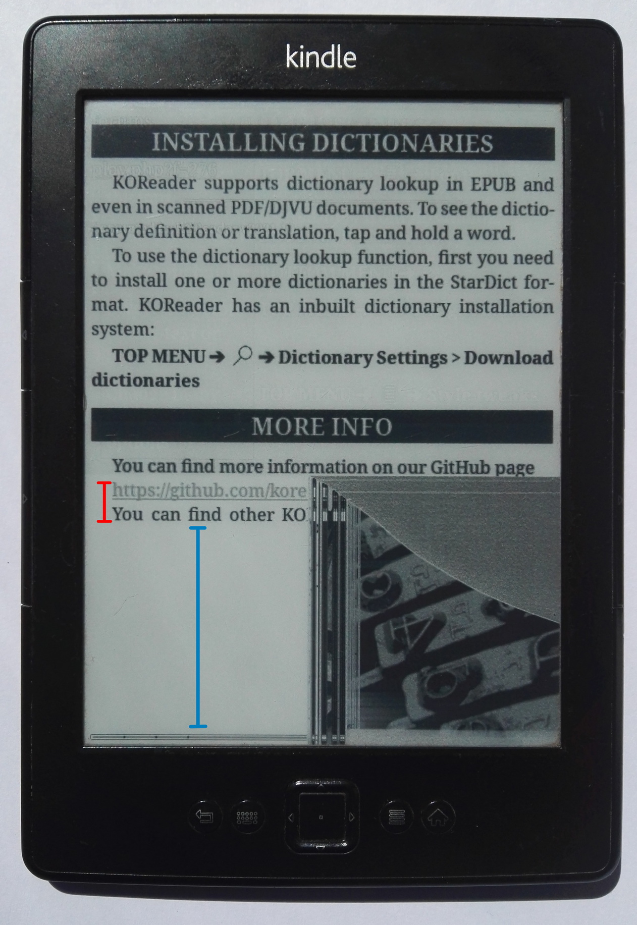

An unknown incident left the bottom right area of this k4's screen stuck. Fortunately, the top part still works well.

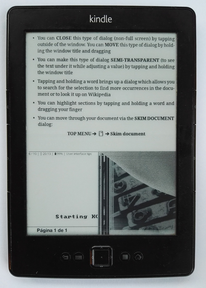

I'm trying to get KOReader to render books only on the top part. I've gotten almost there by increasing the bottom margin size (DCREREADER_CONFIG_B_MARGIN_SIZES), but the max effective value leaves a couple of lines of text below the unusable part (2nd picture).
Any ideas on how to push those last couple of lines up? Ideally the whole UI would be above that height, but we'd be more than happy with getting the entire text to render.
ID:	189692   Click image for larger version

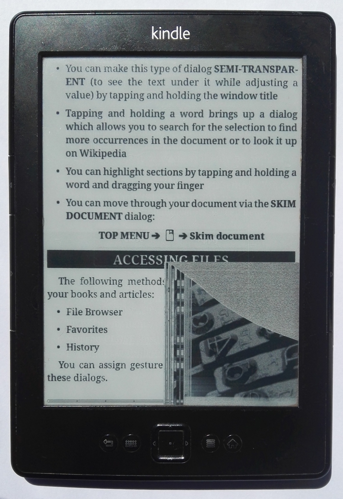

True that. It was rather cool to see the line slowly crawl upwards, leaving everything under it frozen.
It seems to have stabilized, though! It's been like the attached img for a few hundred page turns so far.
I made sure to set the viewport a couple pixels above the unusable area. My thinking being avoiding asking the device to update that part of the screen.
Even though replacing it wouldn't be expensive, I think it was worth the trouble if we can squeeze a few more books out of it as a secondary ereader.
