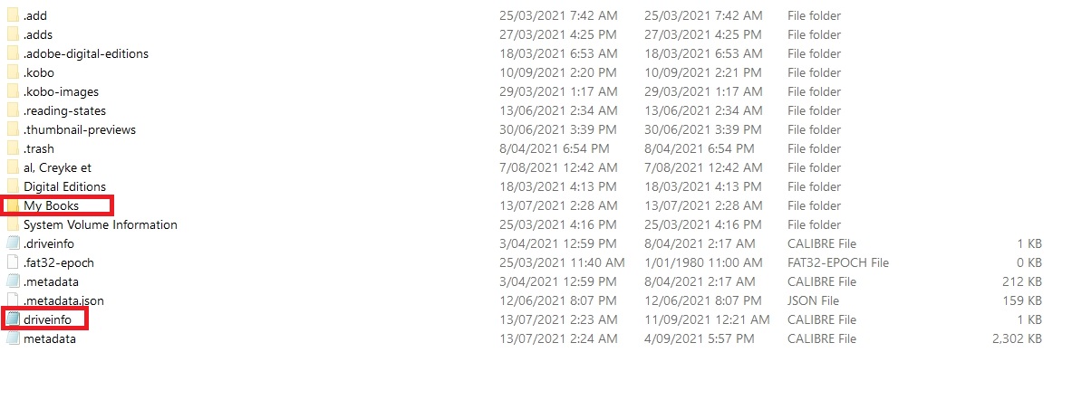

I haven't changed anything except updated the Kobo to latest and make the irrelevant files hidden. I unhid the calibre file you refer to but same problem remains...
Screenshot attached.
Happy to provide anything else.

I deleted the wrongly-placed book above ("al, Creyke") and the error msg is now:

Well well well! It looks like it doesn't like the files to be marked HIDDEN.
After unhiding all the calibre files, it now works without error msgs and showing in Calibre all the books that are 'On Device' !
Thanks for your help!
