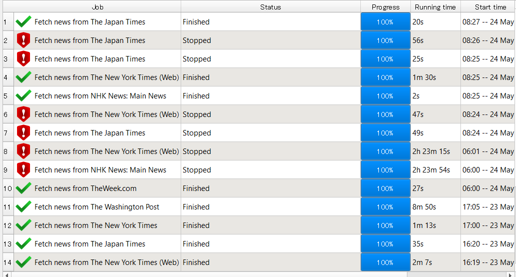

I've attached a screenshot where several jobs just got stuck, 2 of which were stuck for more than 2 hours without timing out. It took several kills and restarts to finally get them downloaded.
I thought the simple solution would be to request a restart option for the Jobs dialog box, but it looks like there is a deeper problem of hanging without timing out going on.

The only workaround now is to just stop and restart the job. It would be easier if you could restart jobs from the Jobs dialog box, but as I said, it seems that there might be a deeper problem of some recipes not timing out which underlies this situation.
