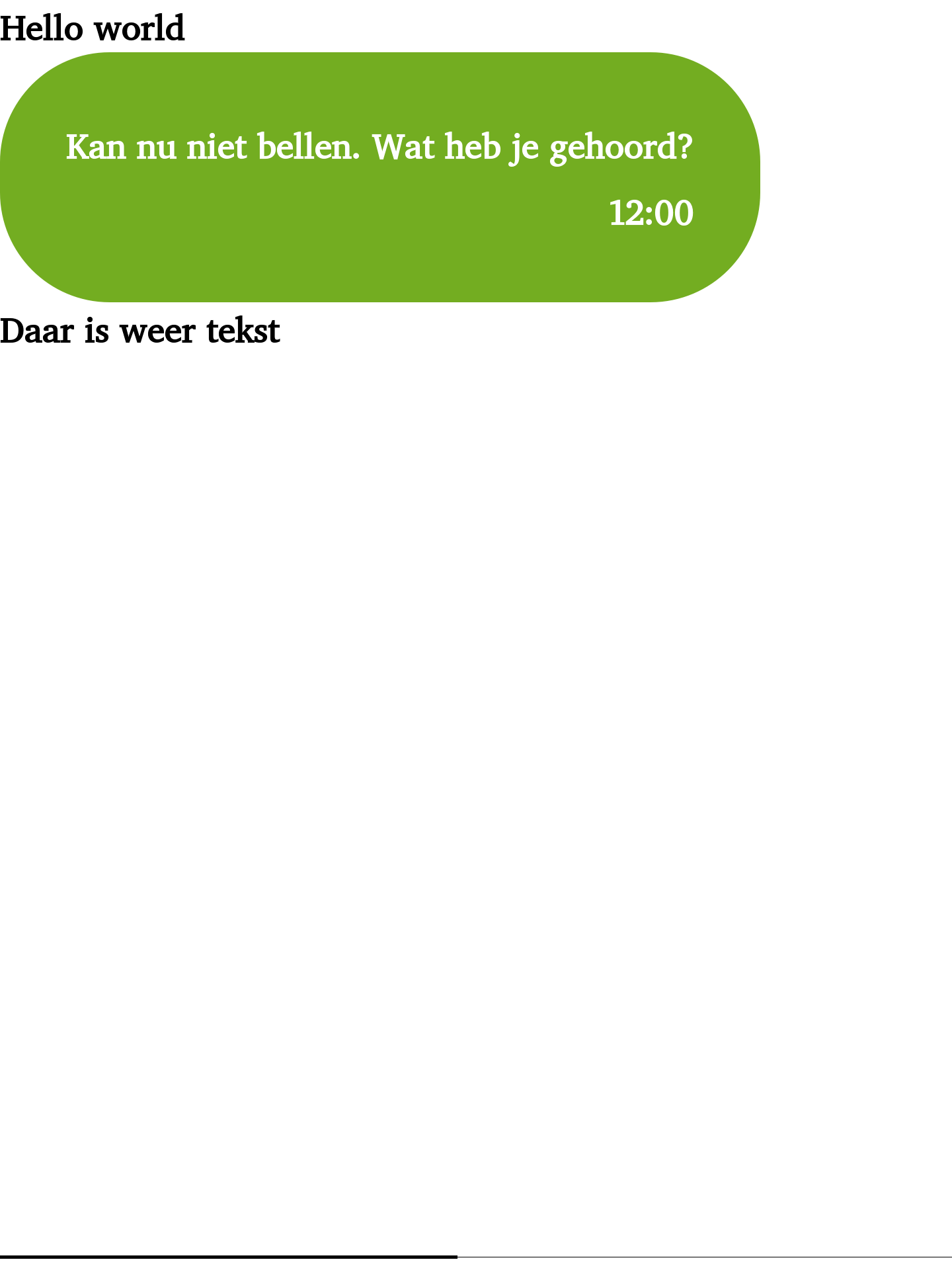

Old 09-05-2021, 10:20 PM   #12
Posts: 49,045
Karma: 174631586
Originally Posted by Skinkie View Post
I am trying something very simple, or so I thought, having a div with a rounded corner in ePub. My HTML works flawless with the beta browser on my Kobo HD, but opening the epub will give me a square box.
Is there any way to get this to work?
Since you are asking this in a Kobo forum, you can always use the alternative renderer built into the Kobo firmware. See the attached images for the display using both renderers on the code posted by MicroDrie.
ID:	189125   Click image for larger version
And what alternative renderer supporting ePub natively do you mean here? I am aware of the beta webbrowser.
Out of curiosity how did you make the screenshots?

Kobo uses two different reading engines; one for Epub and a second for Kobo Epub. The choice of engine is based on the file name. Files ending in .epub are processed by a RMSDK engine, while those ending in .kepub.epub are processed by an Access NetFront based engine.
Some info on the Kobo format can be found at https://github.com/kobolabs/epub-spec
Screenshots can be enabled via an entry in the kobo.conf file and then taken with the power switch. The simplest way to manage the required change to the conf file is to use nickle Menu.
Sent from my Pixel 4a using Tapatalk
