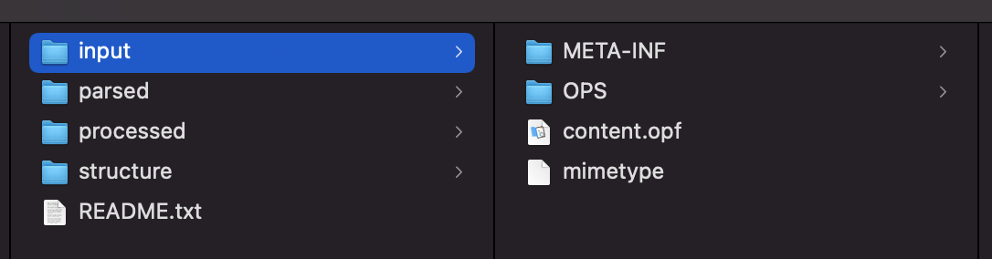

Are you talking about the files I can choose to output somewhere in the "Debug" menu? These logs got 4 folders and 1 file. I attached a screenshot. Please let me know which one you're talking about.
Thank you for trying to help.
The conversion log is something different. From the KFX Output plugin documentation:
You can view the conversion job log after an error occurs to see additional information on why the conversion failed. To access the log, either click on the "Jobs: 0" label in the lower right corner of the calibre window or use the Alt-Shift-J keyboard shortcut to activate the Jobs dialog. Select the failed conversion job from the list (the most recent will be first) and click the "Show job details" button. To copy the log to the clipboard under Windows, click within the log text then press Ctrl-A (select all) and Ctrl-C (copy). You can then paste it wherever you like.

InputFormatPlugin: EPUB Input running
on /var/folders/w3/xrp8mfyn2vxgnm8lg68wg2t40000gn/C/calibre_5.18.0_tmp_wfy43u1e/ilee8dc0.epub
Found HTML cover OPS/titlepage.xhtml
Input debug saved to: /Users/MyName/Desktop/Debug Logs/input

I noticed this warning:
Warning W14010: media file not found
But I don't understand how if the cover is actually there!
Any insight is appreciated.
Thank you.
