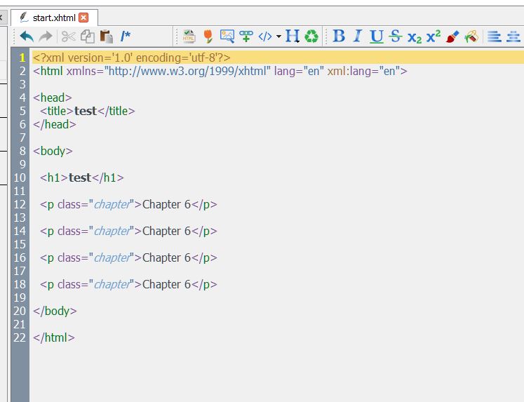

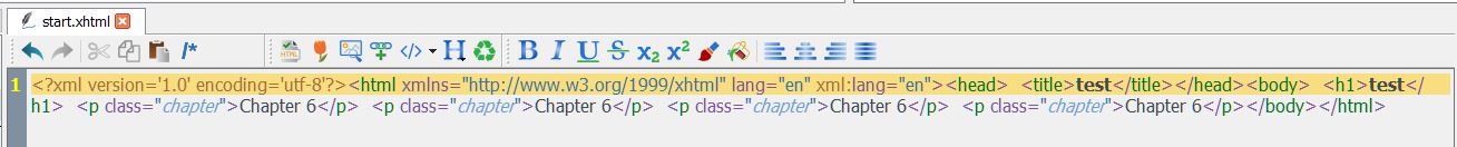

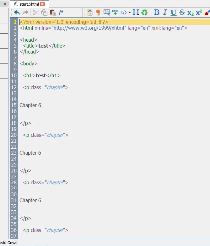

FWIW, I've found that Beautify leaves a lot of blank lines
I usually Replace \n{1,} with nothing and then Beautify (3 and 4 below)
Capture1 = Before Beautify
Capture2 = After Beautify, before Find and Replace
Capture3 = After Find/Replace
Capture4 = After Beautify
Maybe there's a Beautify option I don't know about

For the example given, the results shown are what I would expect from the beautify in the calibre editor. It general, it doesn't touch the text within the tags. So, it doesn't remove extra whitespace like that show after the opening paragraph tag. On the occasions where I see it, I use find/replace to clean it up.
